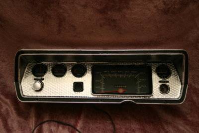

Another way to spiff up instrument panel gauge clusters. Buy a length of shelf paper. Make a template> You could lighten things with a birch kind of paper,
(This one also has White Face gauges) or you might also use something like engine turned aluminum.

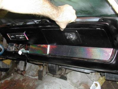

Make certain the template fits well, when the material has been cut. Trial fit before exposing adhesive on back. To assist in locating material on instrument cluster use wet water mist on plastic and a burnishing pen to press material into place and not have air bubbles underneath. The same materials used on the dash can be used on deluxe interior door panels to create a more unified look in the interior.
