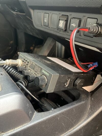

I still have my cb radio from 40 years ago. I haven't used it in 30 years but it is on the shelf if I decide I want to. Yes channel 9 was the emergency channel years ago, probably still is. On older mobile radio's I remember the range being up to 15 miles on a good day. A home base radio would have much more range depending on the weather and skip. Bobby
If I were you and just looking for something to communicate every so often, I would buy a Uniden Pro 520 about $80 or so it's a very good radio. I wouldn't use a cheap lighter plug because it effects the performance of the radio, hard wire it with a quick plug. A magnet mount antenna will do a good job, but you have to get the swr set for the antenna for best performance. Also get an external speaker much better than the built in one. The Cobra 29 LTD Classic is a good radio if you want to step it up.

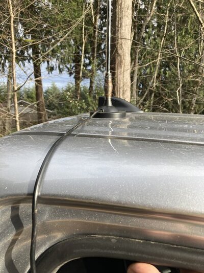

I have a 70's magnet base antenna that does real good.
Better than the new "fire stick" one I bought last year.
