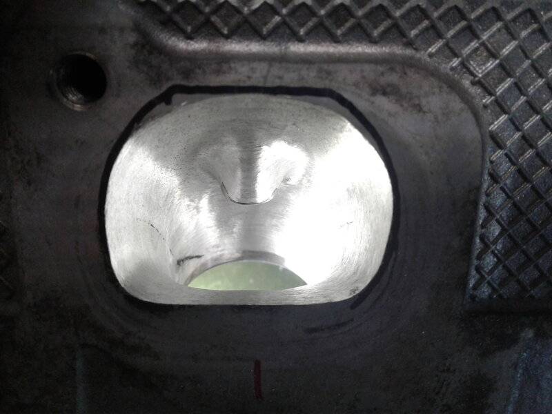

The Exh ports are less than impressive, for sure. But I refuse to throw the baby out with the bath water.
What they come down to is, grind out to the gasket (top arc only) but leave the bottom as is.(size wise)
And then grind accordingly on the roof to blend into that new size. (make sense? )
The pic below is of a head I did in 2018. the goal was to reach 230cfm, that one was in he 226 range.
The pic is kinda skewed by the lens, but hopefully you'll get the idea.

The Exh pic is for the Eagle only. the Pre-Eagle Exh ports are very different..
