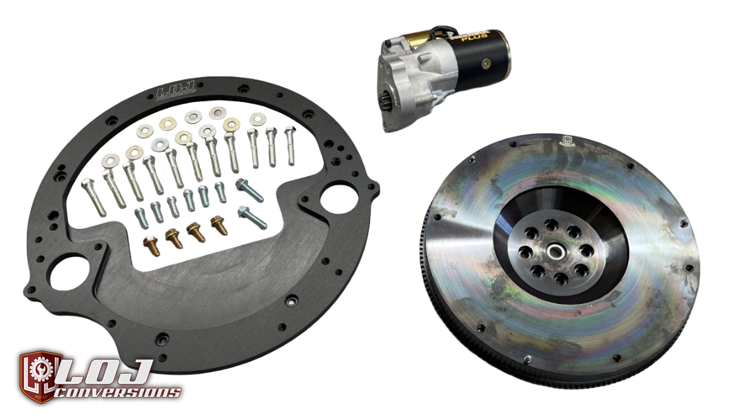

There's a new option on the market for 6 speed conversions using the Nissan transmission. The kit seems pricey, but the transmissions are cheap, making your all in conversion much more affordable than a T-56 swap. I'm curious how well these transmissions would fit in the tunnel of an A-body. A quick internet search revealed some used transmissions as low as $650. The gear ratios are much different than the T-56. Only 6th gear is overdrive and 1st gear is really low. You would likely have to run a 2.76 or 3.23 gear to make 1st gear usable. I don't really see this as a bad thing.
To me, the whole reason to go through the hassle and expense of installing a six speed trans would be so I could run a 4.11-4.30 rear gear comfortably.
Rear gear ratio is irrelevant if the gear reduction is being made in the transmission.

I agree with Joe, doesn't make a lot of difference. This Xterra trans paired with a 2.76 with would feel pretty similar to a close ratio T56 with 4.10's. And as a bonus, people throw away 2.76 gears while 4.10 gears are like gold.
In fact, the first gear in the D50 Xterra trans with a 2.76 rear gear would actually pull harder than a 2.66 first gear T56 with 4.10's. The Xterra trans drops off a little after that, but not by much.
I've seen kits to swap the CD009 trans into other rigs, most of them hack off the bellhousing and bolt a new bellhousing on using the front retainer bolts. But I hadn't seen anything for Mopars so never paid more than passing attention to them. I did find GM kits for the CD009 though, using an adapter plate like the LOJ kit does.
The CD009 has different gear ratios, but not a lot different.
First thought on the D50/D40 trans is what a bonus for someone that is building a 4WD. T56 doesn't seem to have any options but this one can be had with a transfer case.
Only real drawback I can see is the 1-2 drop is almost as steep as the A833OD, 42% for the D50/D40 and 46% for the A833OD. After that the ratios are all pretty tight. I have an A833OD in my Duster and wouldn't say it is horrible, but I know it could be better.
I would bet it would be a great transmission. I think the 1-2 drop will cost time on a drag strip, but for something like road racing or the street, I bet it would be sweet. And if someone wasn't into finding every 10th on the quarter mile, who cares.
Bonus that you can run rear gears that you can pick up for a song (sometimes).
Kind of interesting. The overall gear ratios for a TKO with 3.91 gears are pretty similar to a D50/D40 with 2.93 gears. BUT the D50/D40 trans has one more gear to go. So kind of like running a TKO with an extra gear.
