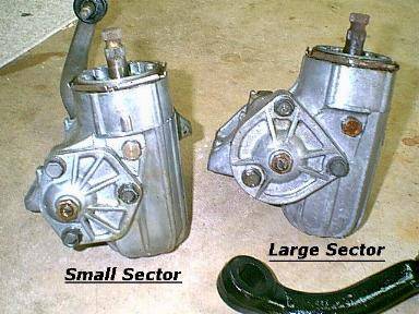

I think you need the 73 up steering box to use the 73 pitman arm but I might be wrong. Idler arm and center link obviously. Tie rod ends are different numbers but I think you can use either...adjustment sleeves might be longer
You need a large spline box SO FAR AS I KNOW
There are 4 components that must be compatible. You need the later center link, obviously, 73/ later idler arm, ad pitman arm, and then a large spline box to fit the pitman. Everything else will fit
Exception is on a 67 if you have the original K member with the oddball 67 only idler arm
I have been unable to confirm the difference, if any, between ear
Y and late manual steering boxes. All of the suppliers I have looked into only offer one box.
power steering box went to large spline in 73 I think the manuals stayed small.
check with Firm Feel they offer both large and small spline pitman arms.
there may have been large spline manuals for C-body’s, truck and vans. I don’t have a pic But the plate on top with 3 bolts is clocked differently then the small spline ones
Found one

The 73-76 A-bodies (E and B too) stayed small sector manuals after 1973.
So… what you need for a 68-72 A-body is:
  • 73-76 A-body manual pitman (small sector with stud points down
  • 73-76 center link
  • 73-76 A-body idler with stud that points down
That’s it
Note: for a 1967 A-body thinking about this conversion, there is no idler that fits a 67 stud mounted idler K-member that has a stud that points downward. So there is nothing that properly fits for the idler.
