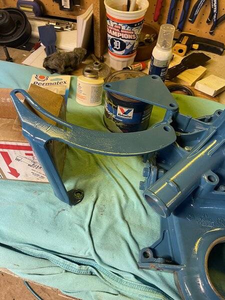

So this car doesn't have A/C, but I can't say the bracketing came on the car to me the way it is supposed to be. I took a ton of pics before I took it apart because I knew it would be a puzzle going back together and my phone lost 'em all. If you have non A/C pics, that would be awesome. Thanks.

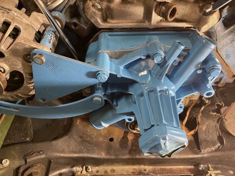

Did a dry fit to try to work it out for myself. Don’t remember the ‘extra’ hole at the bottom of the triangle bracket, but this is the only way it goes together that makes sense.

Have a look at the schematic you posted for the saginaw pump post # 1.
That triangular bracket is for the power steering pump, not the alternator . The triangular bracket for the alternator has two holes that are used to attach the bracket to the water pump. The Alternator attaches to the other hole in the bracket.
I think you are confusing the two triangular brackets.

I see why you would say that but nope that's not it. The (now blue) triangle bracket in the pic above of the dry fit mock up was original to the car (at least as it came to me) and was part of the alternator bracketing. Yes, there is a new bracket that is identical to it that came with the PS bracket kit. It must be a universal type bracket that is used for various applications. That would explain the 'extra' hole. Thanks though.

That's not right... The triangular bracket has two of the long water pump bolts going through it...

just my gut here...
IF the triangular bracket IS the alternator bracket and not for the PS then 2 of the holes would be bolted to the WP bolts, and the alternator would be moved forward so the front ear is in front of the top hole of the triangular bracket. the photos below are from 67 273 with cast iron WP BUT my bet is they did not change things all that much through the years.

What you are saying makes sense and doesn't necessarily contradict anything I've posted already. The things I know for sure are that the triangle bracket is/was a part of the alternator bracketing as the car came to me (granted may not have been correct), and (while I agree) that two of the holes should interface with the water pump, there is no way that can happen. The holes are not spaced in a way that two of them could bolt to the WP. I have to decide if I'm going to put it back together the way it was, or try to find the correct alternator bracketing. Thanks for the input and pics.

The triangular bracket in your first picture is for the power steering pump.... It goes in the long bottom bolt for the water pump, and the next lower shorter bolt for the water pump on the bottom driver's side of the water pump... Look closely at the pictures that I posted....

Thank you for all of the helpful pics. Based on this reply and the last couple before it, I am coming to the conclusion that the person who had the car before me probably mixed up some of the alternator and PS bracketing when they installed the PS pump and/or the new engine (it was originally a slant 6). They also brutally hacked a piece of of the K member to make room for the pump lines. Jebus, why people do what they do and then leave it for the next guy to sort out lol. Which is what I will try to do now...
