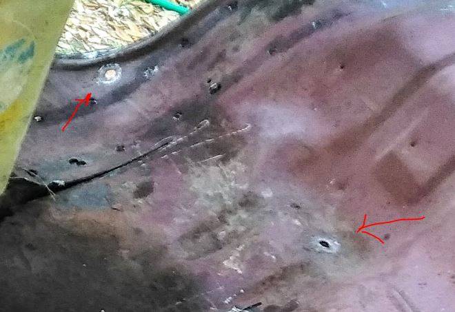

Floorboard is long gone so no dimensions and I hope the photos will help.
From the bottom to give you an idea or approximation, drivers side inboard
Inside 4 locations

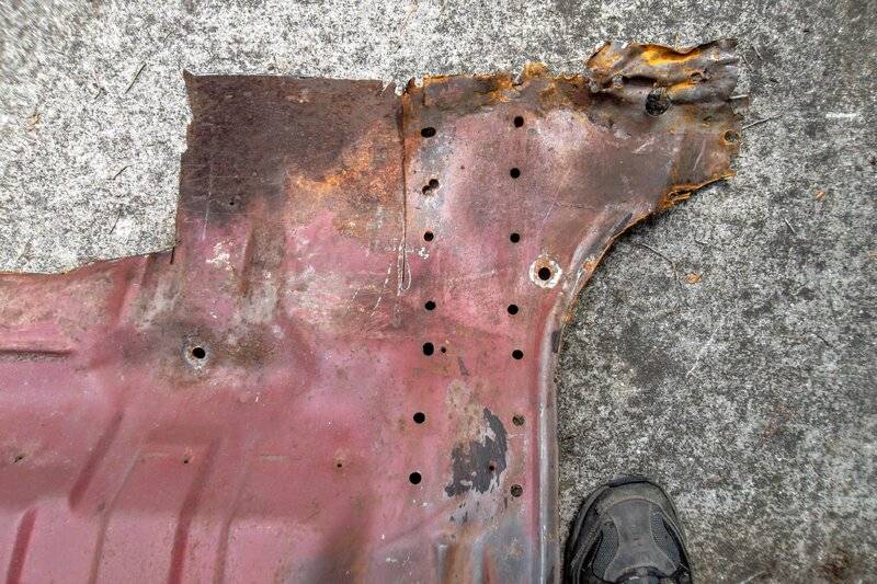

Pass side inboard
Driver side inboard

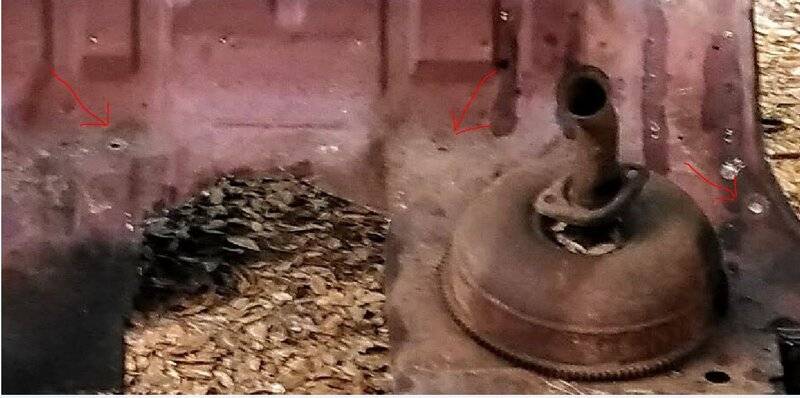

Drivers side outboard(I think thats a mushroom)
Pass Outboard

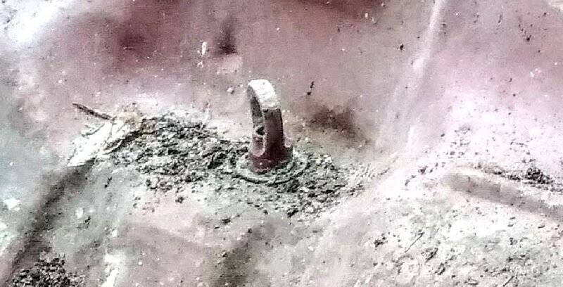

Factory 65 Barracuda Attaching loops and washers(pm me if interested)

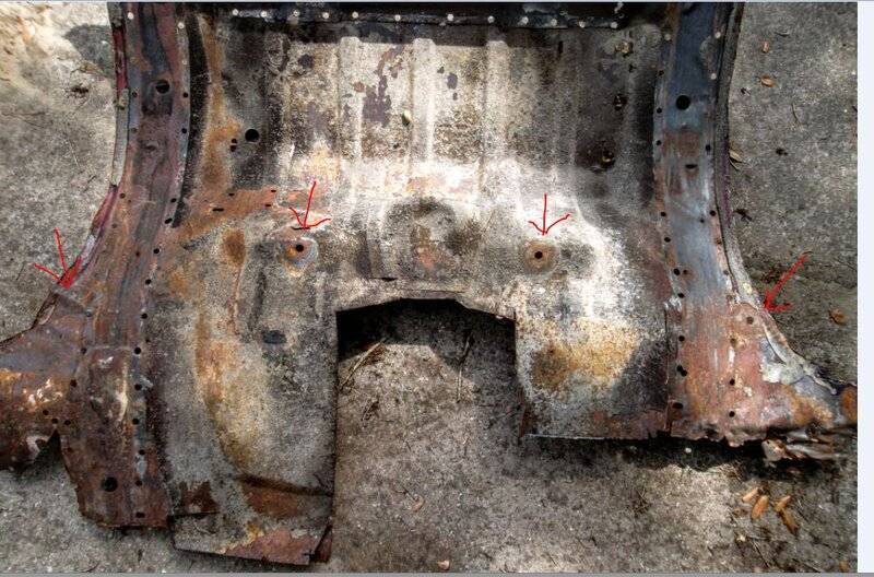

Pass side outboard and inboard
L & R inboard, driver outboard
I'm sure your getting the visual by now :)
Best of the underneath.
Hope this helps. I don't have any other pics. '65 Barracuda factory belts.
