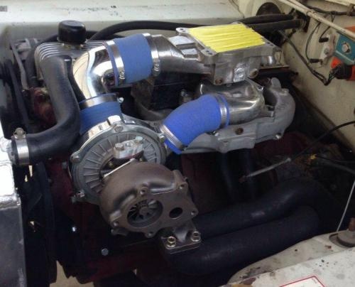

Heres mine. . . Not done yet but coming along.

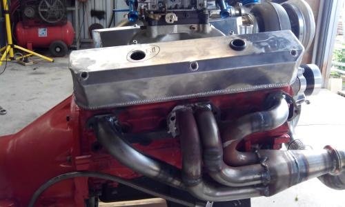

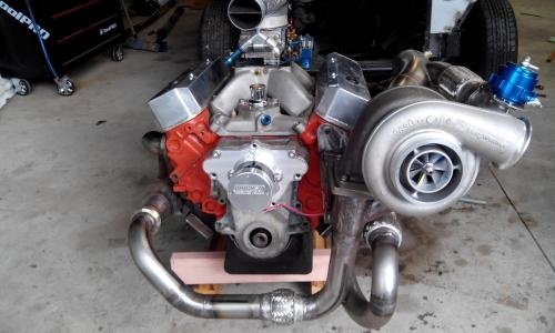

these were for a twin turbo build, but we changed direction
went No Power Adder
stroker 449 / E-85 carb

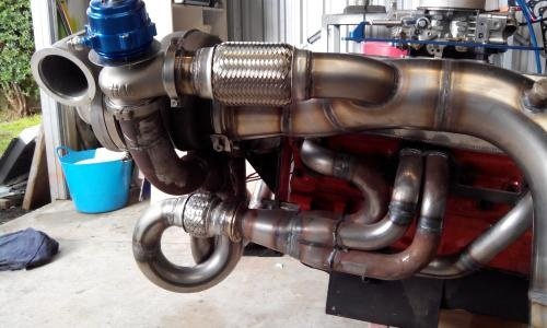

close up
wrapped the headers while on the stand> easier
1 3/4" into 1 7/8" into 3 1/2" collector

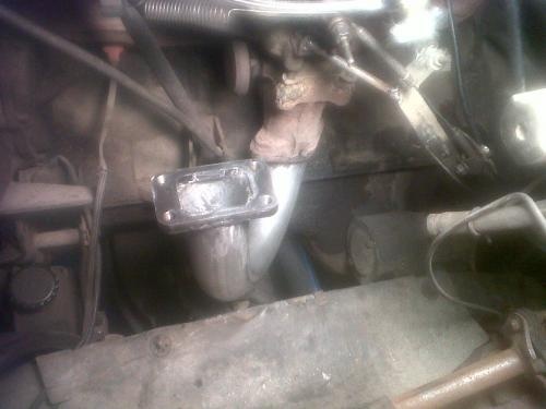

Sorry. This is the best picture I have for now. It's the Clifford dual exhaust coming up to a small homemade box with a T3/T4 flange.

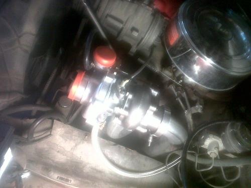

341 Desoto hemi into 67 Valiant.
