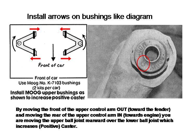

If you like your stock stamped steel arms, you're limited to using the Moog K-7103 offset bushings:
They do work, I have them in my '70 Charger. I must be blessed though because even with standard bushings, this car was able to get over 3 degrees of caster. Now with the bushings, I was able to get 5 degrees on one side, 5.5 on the other. This has to be a case of an absolute positive tolerance stack up!

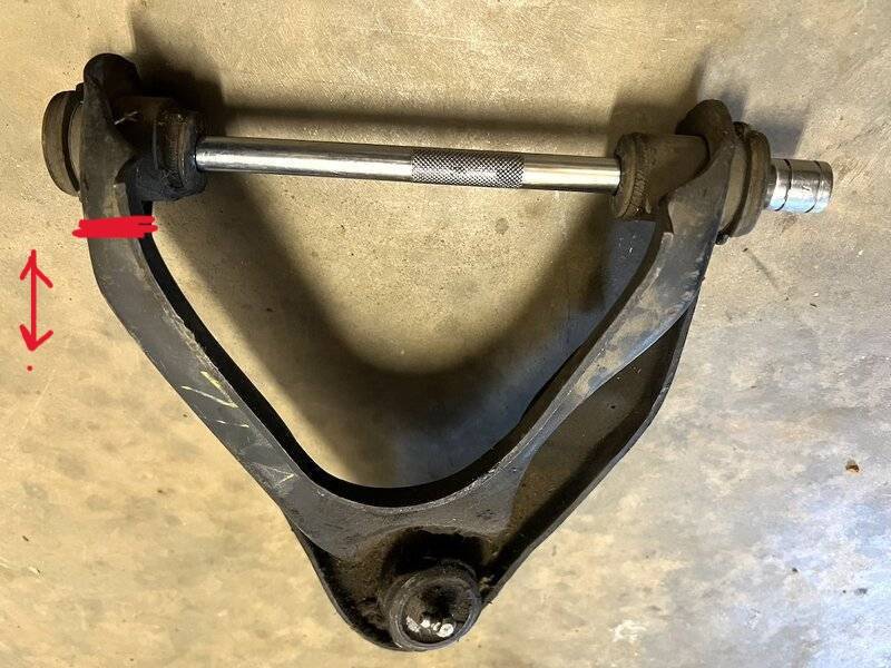

Okay, back to the point. If you're always looking to do more with less and can weld....
How about this?
How about cutting the UCA on the forward leg, spread it 1/4" and welding in another section?
Properly welded, it wouldn't fail. The slight change in angle will affect the rear bushing slightly but not enough to matter. This can be done for next to nothing. The 1/4" piece sectioned in could come from small ball joint UCAs that are not as valuable to some people. By welding in an extension, you'd still be able to use any type of bushing, offset or stock so there would still be the same range of adjustment.
Opinions?

I like the BAC uppers. Way easier to dial in what caster is desired than a fixed amount other UCA's provide.
As a professional welder, I like the idea BUT welding changes the metal. It will be harder in some areas and softer in others.
With that said, dependent on what you weld could effect the torsional twist all control arms face going up and down and shifting body roll. It’s why those expensive control area are expensive. The tubing and gussets are far superior to the factory arms flexing in the case of a road course. Or hard Sunday driving. Sadly most people welds are not up to The welding needed to accomplish your fix. Will this work- absolutely. Will it last?…. I’ve seen a lot of welds in my 54 years and most I would not walk on 1 ft above the ground let alone 50ft up. (inside saying with most professional welders. Would you trust somebody’s welds 50ft off the ground to walk on.)
Syleng1
What Syleng1 says, plus that whole cold work hardening life cycle of used suspension stampings. In the DOT regulations that I know of that the VA inspection station sticker appliers have to abide by, secondhand welding of suspension components is very much so “frowned upon…”
Welding if done right might work A-OK but maybe affordable options with the work already done exists.
Do they have a problem with aftermarket UCA’s though? Because the Hotchkis arms are welded. So are the QA1’s, even the SPC’s have welds around the ball joint sockets.
The weld isn’t so much the issue, it would just be the execution

No problems with aftermarket produced parts as long as they have a DOT approval. But welding repairs or modification of factory parts have to be performed by someone certified to do DOT fabrication work. Our variety of shop for that type of work is semi truck repair and trailer fabrication.
Not trying to be controversial, but is any modification DOT approved on anybody’s car here?
Top A arm is a pretty low tech piece of stamped steel. Given some reasonable welding skills and a little bit of reinforcing, this seems like a great idea for us cheapskates. Like just about anything, a skilled guy can make it work and an unskilled guy can’t.
