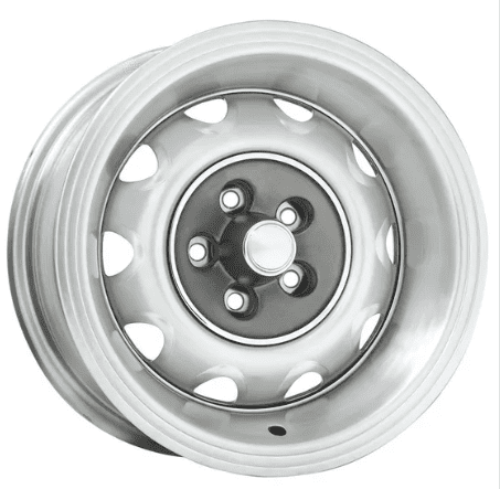

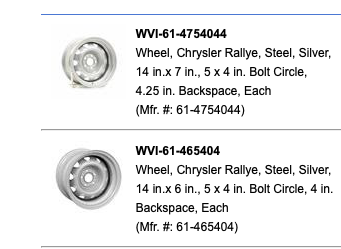

1972 Dart, SBP. I ordered a set of Rallye Wheels from Wheel Vintiques. I had planned on using my NOS beauty rings that I bought many years ago but completely didnt think about the backspacing and how that would affect beauty ring fitment. I don't want a big gap between the bottom of the beauty ring where it meets the spokes which is how the NOS rings look when installed on these wheel vintiques. Doing a google search, I see deep dish beauty rings for 14" wheel but a 2-1/2" or 3" depth. The question is, will they fit? If so , which one? Will they look like the factory installed option (no gap)?
Here are the wheels I have purchased

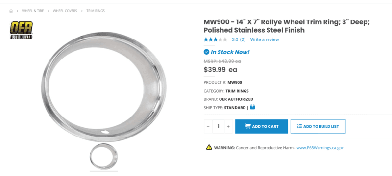

Here are the options I've seen:

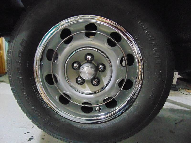

From Wheel Vintiques site (no gap):
They’re cheap enough, buy one of each and test fit both. Keep the one you like and return the other, just don’t scratch em up. Buy 3 more of the one you like. You might find that to get the look you’re after, you’ll need the 3” on the rear and the 2-1/2 on the front.

Below on the wife’s Cúda, 15X10 & 15X7 (IIRC on the fronts) with both trim rings.

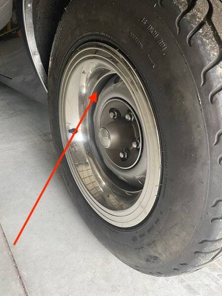

Thanks for sharing. This is the gap I am trying to avoid
I called Wheel Vintiques a bit ago to ask which trim ring was on each of the wheels on their site. She gave me a part number to use on all 4 but then said, the backspacing shouldn't matter on trim ring fitment. Just wheel size. BS does matter though so I am not wanting to take a chance ordering the part number she gave me. Hoping another forum member has been down this road already
No gap on these ones ^

I believe factory Mopar trim rings have "one step" on the edge.
It looks like at least one of the ones above have two or even three "steps".

the depth on your front wheels works with your stock rings, right? How much deeper are the rear wheels? Looks like 3/4 inch deeper from your first post. How deep are the stock rings? Chrysler made 14x7 wheels in big bolt pattern, but I don't know what the backspacing was.

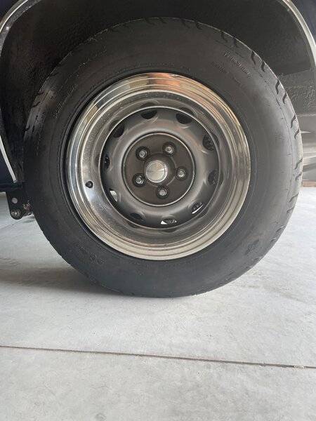

I found a combination that works for the wheels I have, which are posted above. The beauty rings I used are also posted above. The 3" deep dish could use another 1/4 to be tight to the spokes but the 2.5" are perfect on the front. Either way, I'm happy with the look.
Rear
Front
