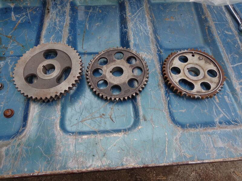

Here are the three basic types of gears that are available for the small block, on the right is the double roller gear, in the middle is the single row metal gear, and on the right is the stock nylon covered tooth cam gear...

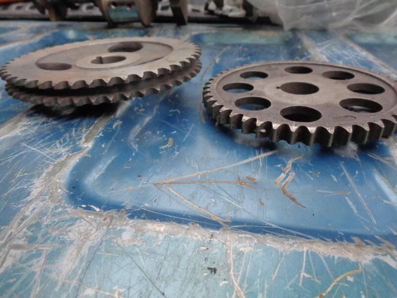

Here is the metal gear for the single row timing chain that is not nylon covered:
Here are the double roller and single row steel gears side by side for comparison:

Here is the steel single row gear next to the nylon covered tooth single row gear for comparison:
