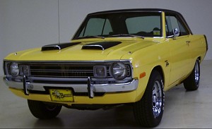

Originally a 6 banger with only 42,000 miles! Now with a ballanced 360, bored over 030 & 4" stroke (413 cid) w/ .50 cam, Eagle h-beam rods & crank, SRP pistons, Elderbrock performer intake & 750 carb, ceramic coated headers, 2 1/2" stainless steel exhaust, MSD6 ignition, distributor & blaster coil. 727 tranny w/2200 stall converter and shift kit. Disc brakes all around, 3.55 aubern posi-trac rear end, 4" alumn drive shaft, traction bars. original vinyl top and interior. no...
