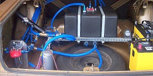

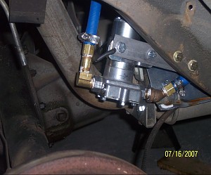

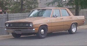

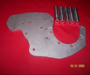

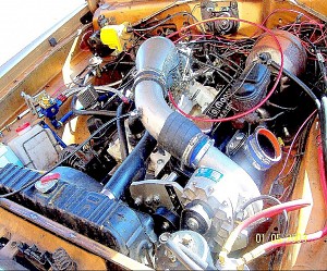

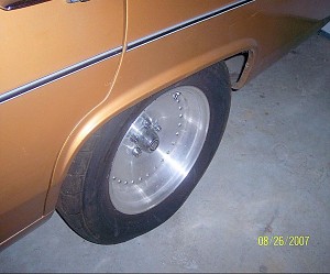

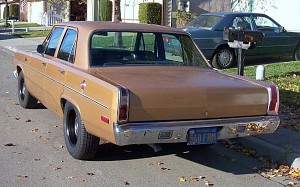

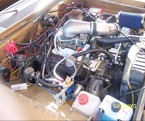

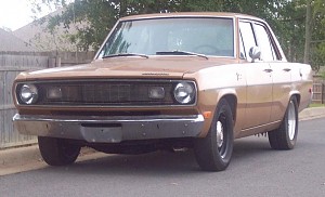

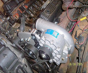

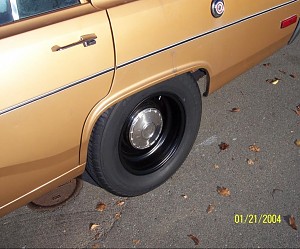

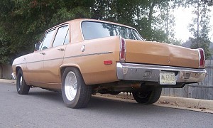

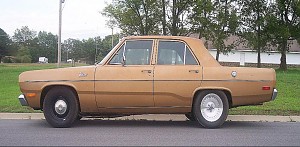

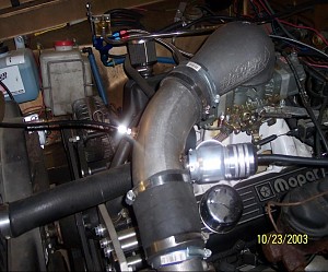

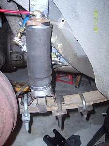

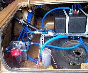

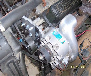

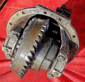

Here are some photos of the Crazy Taxi; one action shot, some exteriors and some tech features about the buildup.
It's an original 318; P/S; P/B; A/C car.
Now has NO A/C, Firm Feel steering, and 8.75" A-Body rear, a pinion snubber, two electric fuel pumps, two filters, a complete half-inch fuel system (pickup to boost-referenced regulator); a 360 Magnum from a 2000 Durango; a Hughes cam, hydraulic roller lifters; a Holley 750 dp 4150 carb modfied for blow-thru by the Carb...
