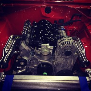

Adam's 1970 Dodge Dart with an LS swap.
1970 Dodge Dart with LS Swap:
  • LS1 5.7 Engine
  • 4L60e
  • LS6 Intake Manifold
  • Ported and Notched LS6 Throttle Body
  • Milled .030 243 LS6 Heads
  • 232/234 Custom Grind Comp Cam
  • Trunion Upgrade (Comp Cam)
  • 7.375 Chromoly Push Rods (Comp Cam)
  • LS7 Lifters
  • Double Spring Valve Springs
  • 42lb Bosch Injectors
  • Nitrous Express Plate Kit 10lb Nitrous Express Bottle
  • Tuned (423 WHP...
