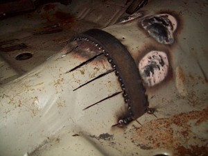

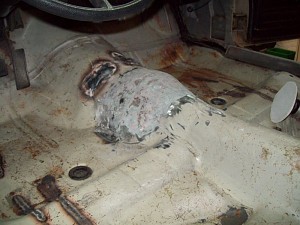

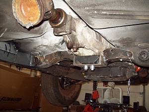

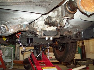

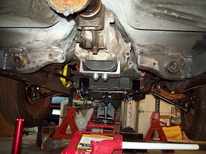

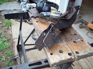

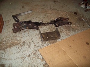

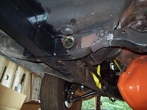

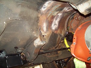

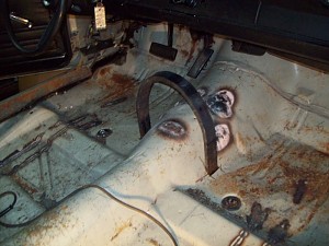

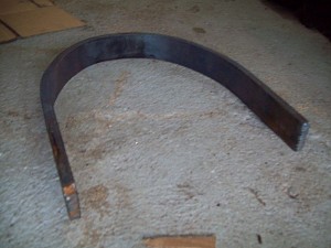

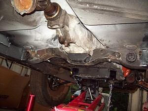

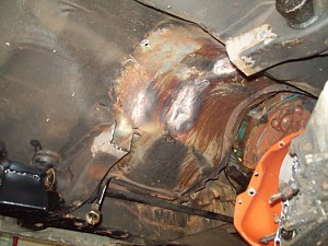

OK, here is how I fitted an A-518 into the car. After i got the 440/727 intstalled and levelled, I set up rigging to hold up the rear of the engine so I could remove the 727 and go ahead with the A-518. I loosely followed Gdonovans A-500 install thread. Its a big job because the OD trans will not fit into the stock trans tunnel. You must remove a section of the factory crossbrace to gain clearance and you must do something to add back the rigitity it provided. The pictures tell the story.
