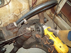

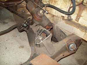

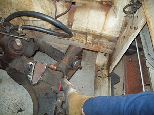

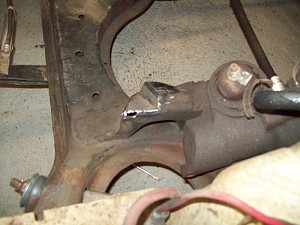

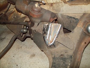

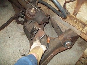

The Schumacher conversion mounts came with instructions to notch the L.H. enginr mount stand to clear the B/RB oil pump. The size and location of the notch varies depending on what brand/size oil pump being used. My solution was to put one big notch into it to clear all brands/sizes of oil pumps. I simply cut the stand and welded in 11 gauge steel plate. :finga:
