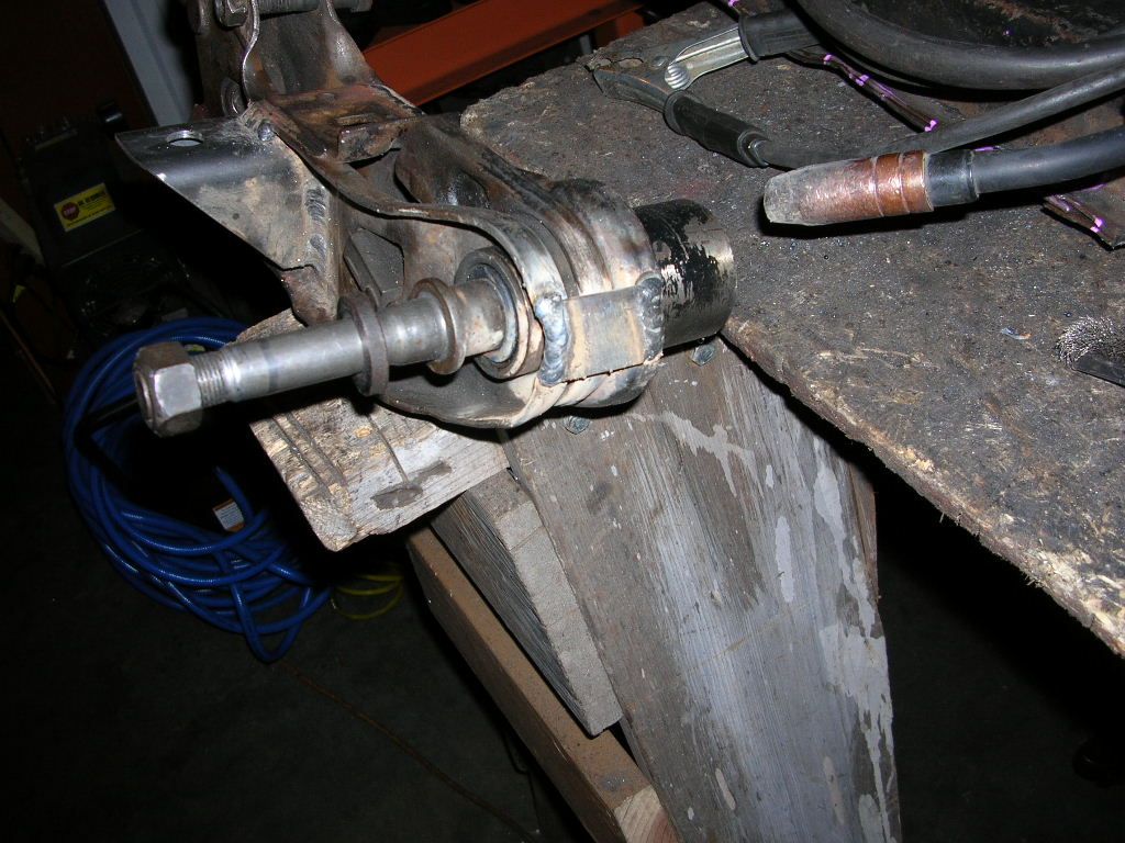

So, I'm getting into welding up my K-frame and LCA, and my sway bar came with tabs, but no measurements for them. Does anyone have a base line measurement so I can go from there?
Thanks!
My Hotchkis bar came with brackets to weld on and fits slick. Probably my favorite part they offer is the 67-72 A body front bar.
Thanks Steve. I looked at that thread a couple days ago, of course the pics don't load. :prayer:
Here is mine in action, thanks again Steve!:
Looks very good. That's not going anywhere.
Did you bent that tab, slice it out of U-channel, cut if from rectangular tubed steel, or something else?
Its out of .120 wall 3x2 steel, all I needed was a 3" hunk, since they are cut at 45. Can't wait to hit some twisties!
