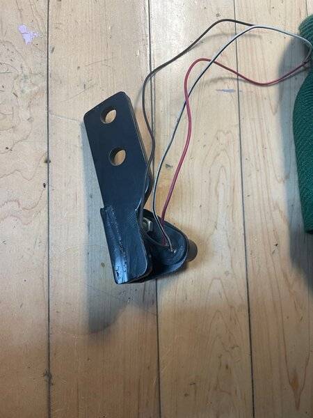

I haven't worked on the car much through the holidays as I've bene busy with other proejcts. I finalize the rear wheel speed sensor bracket and will get it installed within the next couple days. The darn deutsch connectors are on backorder, so i may hardwire them for now just to get going. I'll share some pics once I have it installed.

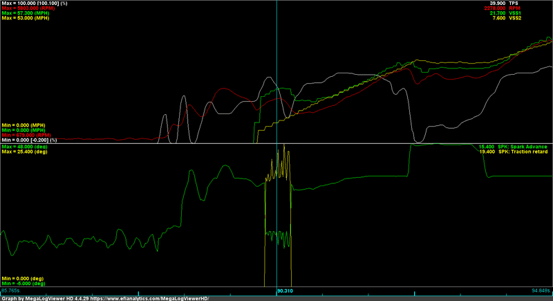

Here's a screenshot of a datalog from an auto cross event over the weekend. This is showing the traction control at work. The line legend is shown in the top right of each graph. You can see when the rear wheel speed (top green) runs away from the front wheel (top yellow), the computer starts pulling timing (bottom graph). All this happens in about .1 seconds.
I'll be honest, I didn't know the traction control was taking over when I was driving. I thought it just started hooking up. There is a dip in throttle during the wheel spin, but that was only about .5 seconds. There was a cone shortly after the start and I was trying to pedal it to gain some lateral control.
