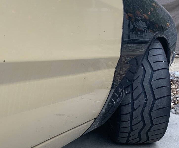

When I started, I had a normal alignment (don't remember the specs) and that wore tires our very quickly on the autocross. I stepped to -1 camber, maybe, and it still seems to wear the outer edge of the tire, but was a little better. I'm hoping these settings get the tire flatter in the turns.
Funny you mention the camber with the wheel turned. When I got home, I turned the wheel to check it out. I snapped a pic to send to a buddy.

Damn I need to get some 275s on the front! I may end up getting the wheels I have widened. Rocket Racing sold out to Holley and they immediately discontinued my wheel. I was hoping they would have expanded the size offerings. SMH.
Yeah I've found that too much past -1° camber and I start to get camber wear, but that totally depends on your driving. I spend too much time commuting, for primarily autoX use I can totally see how you'd get wear from not enough camber too, just depends on your going straight vs turning time. And of course the more aggressive driving of autoX will wear them faster, so that kind of wear would show up a lot faster.

Definitely get some 275's! I love mine. They're not as dramatically harder to steer as you might think, and man do they grip! Eventually I'd like to have them on 18x9.5's or 18x10's so they're not the little bit squeezed that they are on my current 18x9's. Plus I may entertain going to 285's at some point, I think I have the clearance. And I have some more clearance I think I can make if not.
It funny how proportions work to me. When I have one of my 245 width tires off, it looks plenty big enough. Bolt it on the car and it looks barely bigger than the stock tires did.
Not that I am going to throw them away, just funny to me how different they look when on the car.
