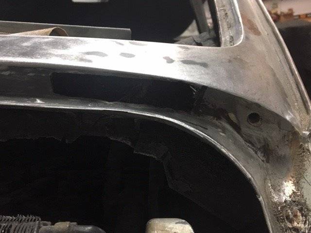

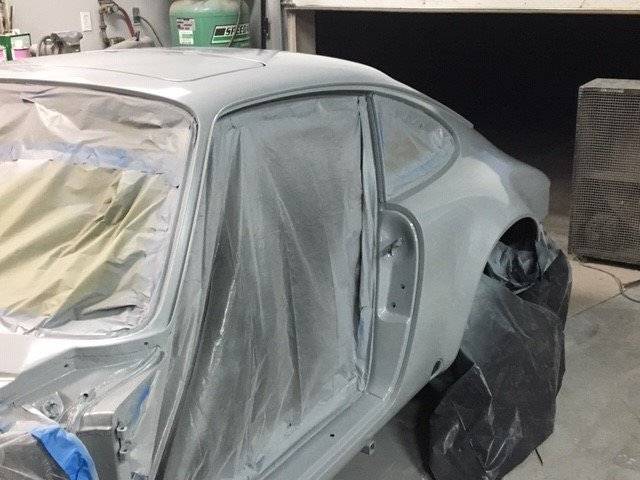

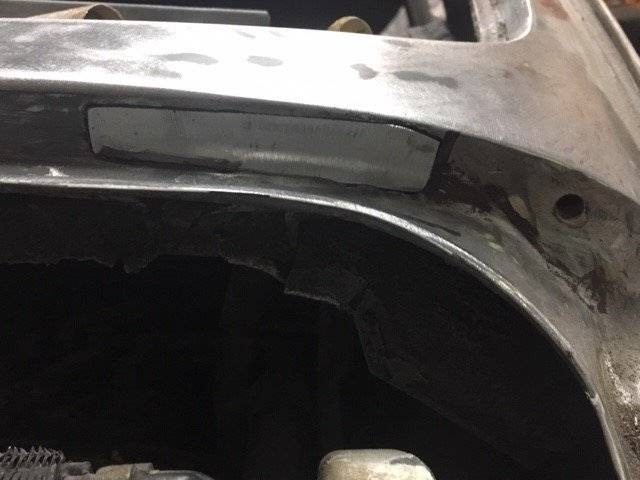

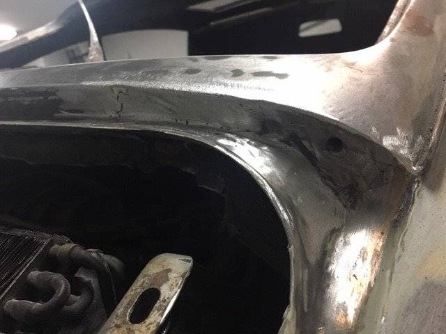

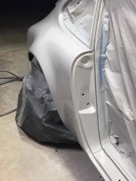

Here are some pictures. These are the only 2 real rust holes on the whole car. I also had to do some significant door gap repair on the passenger side which I ended up building up the door edge with about 1/16-1/8" of weld to close the gap. As of today, the doors, roof, quarters, rear decklid are done and have been blocked and primed twice. I'm starting to work on the front fender extensions which is starting to look like it will take some time and patience...
