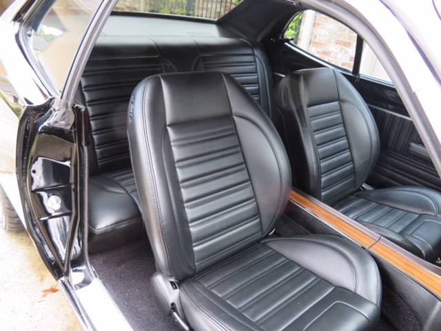

Last pic is full TMI interior. Super comfortable seats. I had a local upholstery shop install the rear cover.

nice selection on the seats, sporty but begs comfort..... IF Mopar would have made the "sport-brougham" edition in the day, you would have been the pick to head the design staff.
:rofl::rofl::rofl::rofl: Best comment ever!

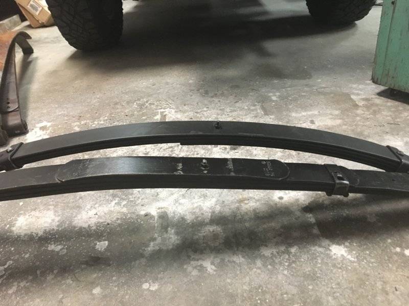

I've been putting a few miles on the car and have been chasing a pinion angle vibration like crazy. After my last ride, I get home and notice this. I've become victim to the crappy Mopar circle track springs deforming. Essentially the spring has an upward curve in it ahead of the axle. This forces the wheel backwards. These springs do push the axle back 1/2', which was great because it centered the wheel in the opening. Not so great now. Hotchkis springs are on the way. I've read good and bad things about the Hotchkis springs, so I hope I get lucky and they aren't too low.
interesting, you sure there isn't sumpin else going on? I have no idea, but never seen this before (which BTW, don't mean chit).

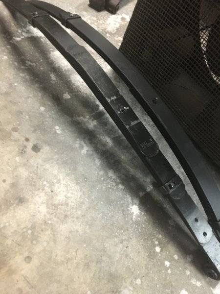

Here’s the circle track spring compared to the Hotchkis spring. I’m sure you can imagine what it looked like with weight on it.
I saw your post in another thread regarding the oval track leaf springs......new one for me. Thanks for the education.
when we put the California Flash back to original removing the coil overs and re-installing the leaves, we did the opposite and moved the pin forward 1".
I hope you have better luck with them than I did. I was worried about the Hotchkis springs being too low since that seems to be the biggest complaint. I think they sit perfect. I hope they don’t sag too much.
I did not use them (oval track springs). I used a set of 23K miles OEM 5 leaf springs, dis-assembled and redrilled the centering pin on the top / longest leaf 1" further forward, the second 1/2" further forward....and left the other three as is. Re-assembled and installed. It put the tire in the opening right where it needed to be. On the Flash, the springs only hold it up and keep the rear centered, the ladder bars do all the work.
