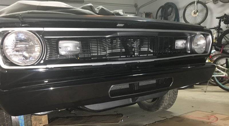

When I decided I was going to paint the bumpers body color, I knew at minimum I wanted to remove the exposed bumper bolts. After staring at the front bumper I realized I didn't necessarily care for the huge indent for the license plate. I wanted to do something to clean it up. I initially thought of just covering it and adding fog lights spread out (between the bumper brackets), but I finally decided against that. This project sat on hold for a while until I finally decided if I really liked what I came up with. Below is ultimately what will get installed on the car. I should have it painted in the next week or so.
The angles are the same as the grill opening. In fact, I used the recess in the fender where the headlight bucket sets as a guide for the angle.

Mostly for looks, but I'm sure more air will get to the radiator with it. I'm going to put some type of mesh or stamped sheet metal behind it.

I painted the front bumper earlier this week and did a little scuff and buff. Here's a teaser pic. Notice the reflection of my phone at the bottom. Man I love freshly polished black! I should have it mounted up this weekend. I'll share some more glamour shots when that's done.
Got the bumper mounted up last night. I used some aluminum mesh I found online to fill the hole.

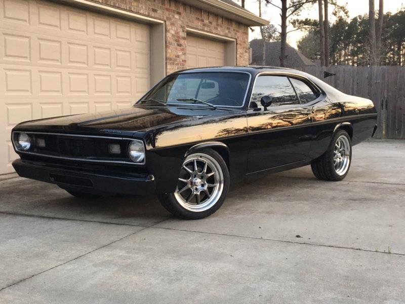

Put side stripes on last weekend. Hard to see in the light of the garage, but that's kinda the point when putting black stripes on a black car.
Steam Rollers!
Well not exactly, but this will be the widest set of tires ever on this car! That's 42"of tread. Wheels showed up also, so some glamour shots will be coming soon.

These are Rocket Attack wheels by Rocket Racing. 18x10 with 285/35-18 and 18x8 with 235/35-18.
That rascal is beautiful!!! I have had 2 black ones, and boy ate they hard to keep clean, but so beautiful! I love the look of those wheels, reminds me of the mini lites. I admit I generally do not like the looks of the 18 inchers.
I wanted mini lites, but unfortunately no one offers an offset that would work well on the front. 18s weren’t my first choice but I needed something to clear bigger brakes and wheel and tire choices for 17” plain suck. I’ll admit I was apprehensive at first, but I’m super happy with it. I will need to lower the back a tad to get it sitting right. They are new springs so I hope they settle in a bit.
Pictures above are the first time the car has moved under its own power since I started this rendition of the car. I have to say I'm extremely pleased with the look. I need to get the *** end down a little so it sits level. I'm also waiting on some brackets so I can mount the front seats. I wish I had them because I would have driven around the neighborhood so I could mess with a tune a little.
