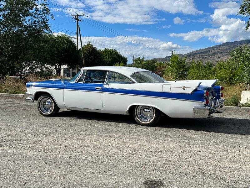

It's interesting seeing the small differences between your '58 and my '57. Mine was originally red/white but was repainted sometime in the early 80's. As far as I can tell, the red was where the blue is now, the white was the same.
This pic is when I bought it, I've now got the original wheels back on with the hard to find Lancer hubcaps.
Very similar years, from the obvious, tail lights and # of headlights, to not so obvious, 57 dash vents turn, 58 are fixed.

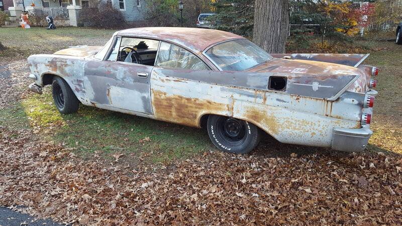

Found 2 pics today of what I believe is a 57 D-501, hardtop no less, black/silver roof no less even more.
Been thinking on doing an old old school nascar vibe.
This car is not getting a restoration or fancy paint. It is getting the rust fixed and a cheapo homemade paint job, whether that's spray gun or cans.
As close to original as possible, charcoal grey, silver roof/trunk/fins.
And either my crappy Cragar GTs, or my shiny ones pictured below, possibly with spinners.

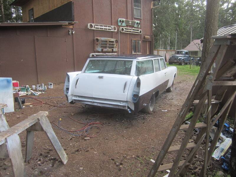

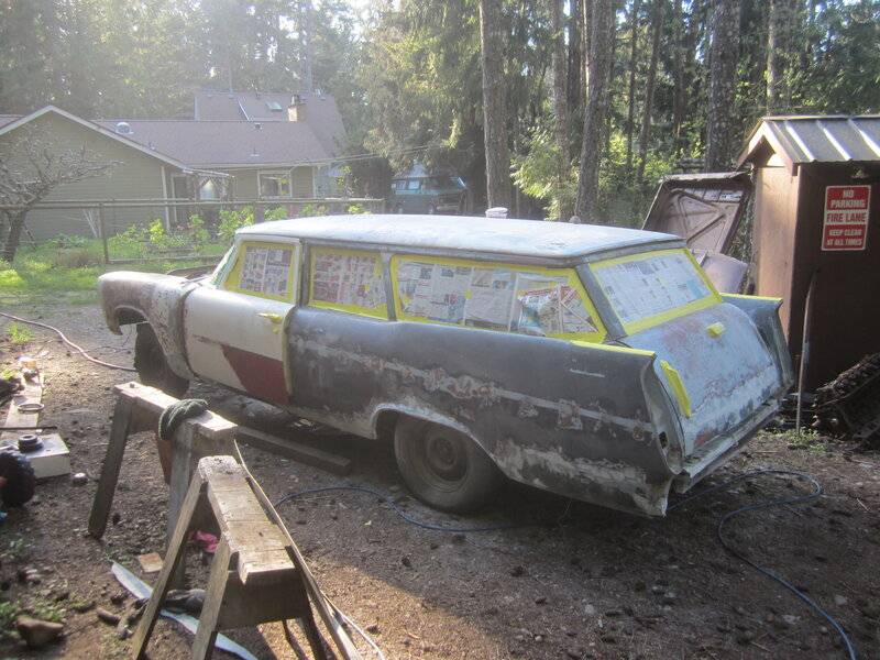

Build it exactly how you want to, don't listen to the BS about how you should have done it this way or that way. I painted my '58 Plymouth 2 door wagon outside, in the dirt, with a spray gun and left over single stage paint from my '65 Valiant (the cheapest single stage paint I could buy). Not all of us have the funds to take the car to the big shops, or to buy the expensive paint. Not to mention we don't all do show quality work. I have tried and tried to paint my own cars, and they all turn out driver quality. I'm happy with them, but it sure bugs other people for some reason. They all think if it's driver quality, it's not good enough. I thought the fun in this hobby was learning how to do things ourselves. Anyone can pay someone else, the true hot rodders do things themselves, no matter how it turns out.

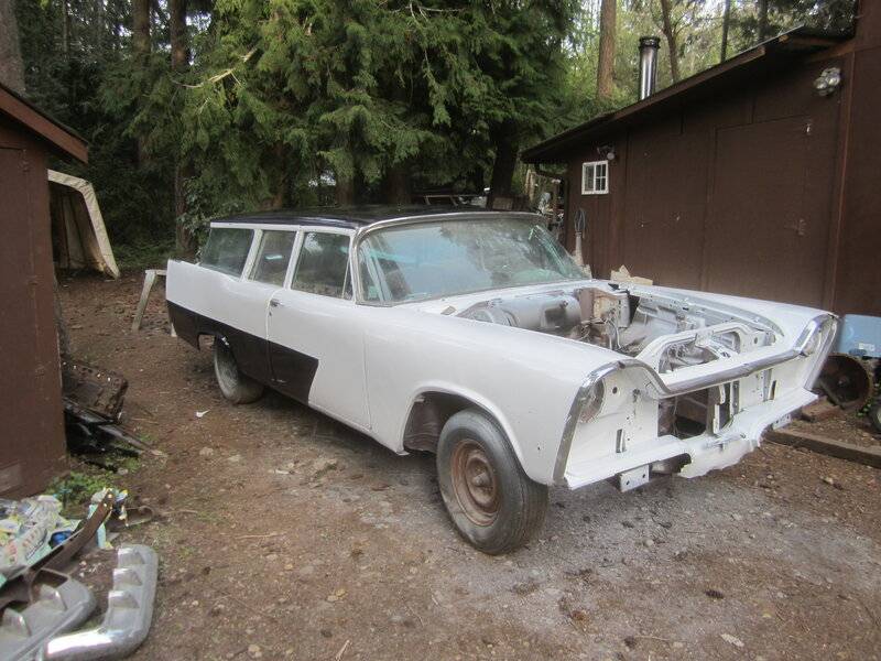

I like it. Plymouth wagon w a dodge front clip.
Yeah, the Canadian Dodge's were built that way, a Plymouth body with a Dodge nose. Except mine isn't one of them, mine is actually a Plymouth body and supposed to have a Plymouth nose, you can see it in the first pictures. But I was missing most of the parts so I put a Dodge nose on the front because it's what I had.
