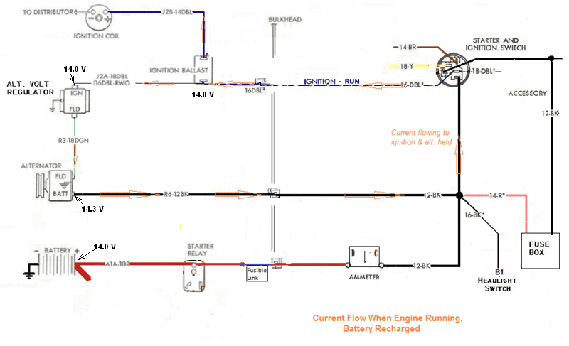

Two reasons.
a. Voltage drops with increasing current through a resistance.
b. When the engine is running, power is coming from a different source - the alternator. Therefore current flows through different path for some of the journey.
There is another difference related to both of the above. Most devices draw more current when given power at a higher voltage. The battery only had enough charge to provide power at 11.8 Volts. In your running test, the alternator was providing power around 14.4 Volts.
However in your case, the voltage drop is greatest when powering from the battery.
That would suggest only b - the route is the cause.
To really know if the drop larger or smaller, measure the voltage at the alternator vs. voltage at the ignition wire.
Alternator vs. Battery
This is the trick to understanding the main circuit.
The car has two power sources. Current flows from whichever one has the highest voltage. (unless there is really high resistance in a ground or route)
The battery and alternator feeds join with the wires to the various circuits at a welded splice.
We can think of this junction as the primary power distribution point.
From this distribution point, power can go to the headlight switch, the fuse box, and the key switch.
Is there anything else between the ignition switch and the firewall? I actually changed out the connectors and a length of wire that seemed a little brittle at the switch, but that didn't change anything. It's obviously not something to lose sleep about; I've been driving it this way for years.
If the insulation is brittle then likely at some point it got hot - too hot. I say likely - there may be other environmental causes - you know the car and its history and I don't.
As far as I know, the ignition wires all go direct to the firewall connection. But I haven't looked at a 65 or a 65 diagram to say absolute.

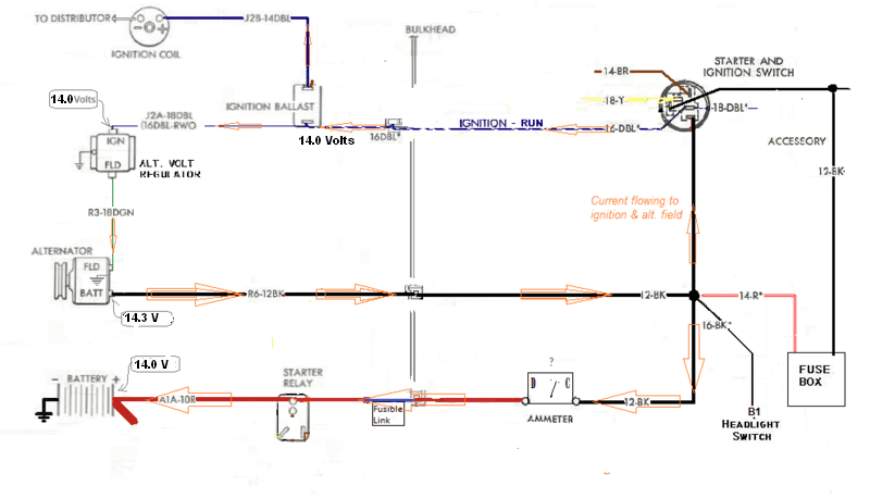

The alternator and battery feeds first go to the main splice as shown in the previpous post.
I forgot to mention that when checking the voltage drops from either the battery or the alternator, check the ammeter.
When using battery power, the ammeter will show how much flow is going out.
When running on the alternatior, the ammeter will show how much current the battery is using to recharge. A low battery seeing 14.3 Volts might be draw 30 amps, but one that is fully charged will draw zero. That's a big differenece when considering voltage drop. In the first case the alternator is providing current to ignition and maxing the rotor plus 30 amps to the battery. In the second case its providing power to the ignition and minimal to the rotor for a total of 2 to 4 amps.
Above scenario we can be confident that the voltage at the battery is the same as voltage at the main splice.
However we don't know what the alternator's output voltage is.
In the scenario below, voltage at the battery will be less than at the main splice. Because current is flowing through that wire, some resistance must be expected the wire and at each junction.

When we measure voltage as we've been doing, we've been assuming no resistance in the ground paths.
The current returns from the rotor through the block, as does the ignition.
A way to isolate the drop is to directly measure voltage differences in the line where current is flowing.
Here's an illustrative example.
In this example, there is little drop in the first section of the battery circuit. However there is a big difference in the return from the alternator case to the battery's negative post. So in this example, most of the resistance is in the return path. Next steps would be to check the alternator to block and block to battery.

When I was getting my fuel/temp gauges working, I was careful with the ammeter connections. They're tight and clean; I did that work less than a year ago, and I was able to look at them under the dash yesterday. They're good. I don't know if I mentioned that in my backlog of text so far.
I see. You're figuring "if I replaced or checked it, its good", so what didn't I replace.
I'm going by the voltage drop readings - and those don't agree with the conclusion that there is resistance in the "battery hot wire from the splice to the ignition switch"
