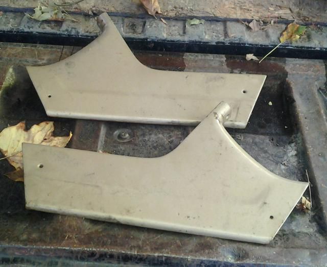

so have been asking a lot of question here and been getting great help. hopefully someone can help me with this one. my car that i purchased does not have the headliner in it. it is a gt model. does the headliner go all the way down the sail panel or is there panels that go there? i only ask because i found sail panels but they are not local to me. i figured if they need to be there that i would buy them. what about trim. i have been searching google for interior pictures but can not find any. any help will be great thanks.
The headliner comes down past the top of the sail panel,then sail panel goes over top of it.It did in my 66 Dart anyway.
They look like the ones in my 65 Dart 2 dr GT (stored away for now). I like these metal sail panels. My 65 Newport has covered hardboard instead, which is harder to restore.
