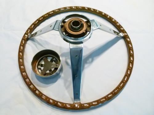

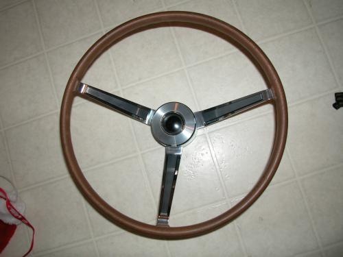

I found out that the NOS steering wheel I found didn't had the copper signal switch on the underside of the steering wheel. That contactt, is that the same as the standard steering wheel?
Any have this switch ring in NOS condition for sale?
