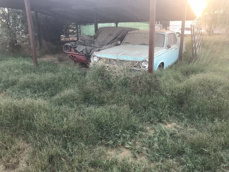

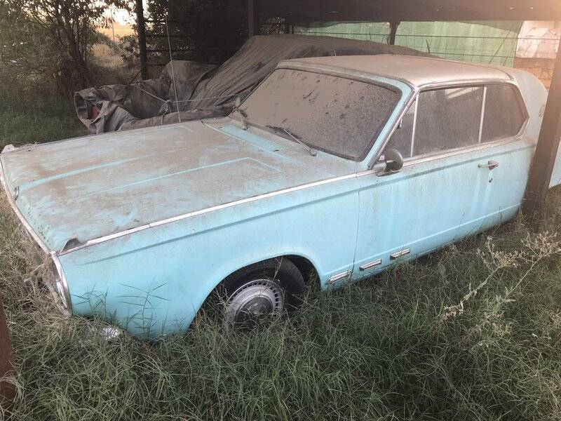

Hi all, introduced myself when I first came on board. Really appreciate the resource, and have learned a ton so far. This has been a very slow process for me—it’s not a full restoration, and I have no prior experience working on cars. I’m really just enjoying the journey.
Background: First saw the car in the backyard of one of my friend’s parents’ house. His dad is a Challenger guy, so has a few of those sitting around. I loved the dart when I first saw it around 2012. In a weird turn of events, I ended up marrying this friend’s sister in 2015, and their dad gave me the dart in 2018... Their family has 6 kids (5 boys, 1 girl) and none of the boys picked up the hobby. So I’m the lucky one.
He also has a 1965 convertible that is more “restorable”, but I liked the blue hardtop and was able to convince him to let me work on it after about a year of hinting interest.

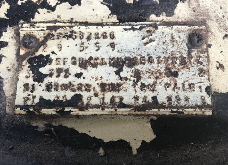

As I started to look into the car more, I decoded the fender tag. Looked like it was a 273 4 Barrel car, pale yellow, manufactured in LA.... sounds like a Dart Charger, right? I contacted Ulf about the car, and he ended up adding the car to the Dart Charger database. Still hard for me to believe it, considering that my father in-law traded a go-cart for it 15 years ago.

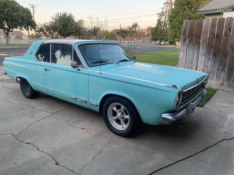

Honestly, with enough existing changes and my budget, priorities are to:
1. Get it on the road and relatively reliable (just about complete)
2. Minor upgrades and cleanup, and install a HIPO 273
I hope that it will be pale yellow again someday, but am aiming to keep it true to form rather than factory correct.
The story is that the car was purchased at a local dealership new, and never left the area. The previous owners had the car in the family a long time, and had several motors in it. The last iteration, they blew up a small block, and used a 1974 a body to donate motor, OD transmission, rear end, disc brakes, power brake booster, and probably more. The interior has been redone—black vinyl and carpet, turquoise piping, etc.
Floor pans are hanging in, typical rust around rear quarters.
I worked on it for about a year in the dirt. Yesterday was the 1 year anniversary of bringing her home. The car lives in a garage now, which is a big plus. Since pulling it out of the weeds,I’ve done the following to get the car on the road (probably will forget a couple things):
-Cleanup
-Carb rebuild
-Spark plugs, wires, cap, rotor
-Conversion to manual brakes as a cheap fix for leaking booster/master cylinder
-15x7 wheels all around we’re donated, so I took the deal and bought new tires (215 60/15) all the way around
-Gas tank
-Sending Unit
-Mini starter
I’m not claiming any awards on color scheme/looks at this point. This has been an exercise in frugality. Doing what I can to enjoy the car on the road.

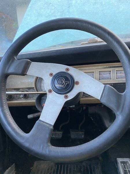

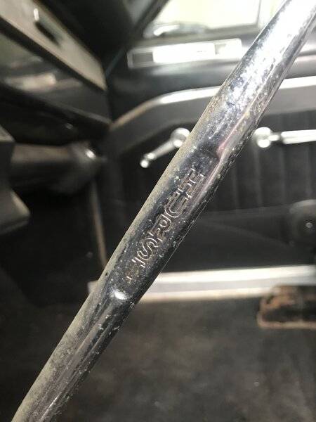

Took out the leaking power steering, and swapped in manual steering. Had been able to source a manual column and box in good shape. Got seals and gaskets from Detroit Muscle Technologies, and the turn signal from @slantsixdan. Included installing a woodgrain steering wheel that I picked up last year. Of course I didn’t take make pictures.

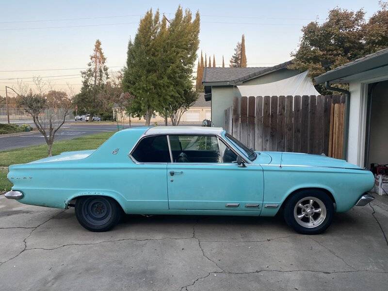

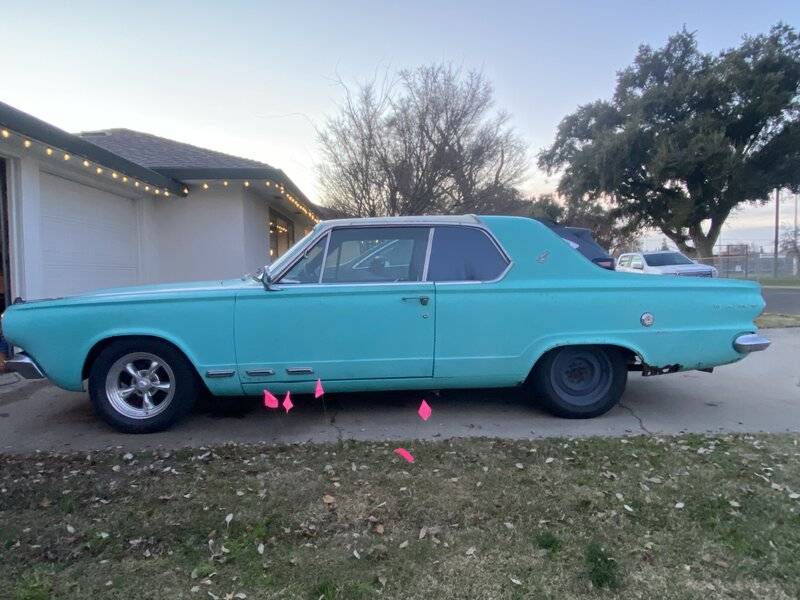

The front end has always looked tall. Lowered the front about 2” using torsion bars. Looks better and seems to drive better too.

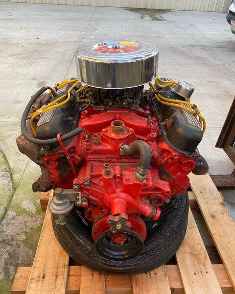

My daughter and I picked up a pretty clean 1967 273 last weekend. Inspection camera shows two valve reliefs. I need to do some more lookin, but we might just run it.
I think all I need to pick up is an electronic distributor, and a find a 273 flywheel. I have two slant 6 flywheels, but I’m not excited about drilling out that one hole.
I guess, I’ll probably need to figure out/decide how to deal with the large A833 od input bearing in the stock bellhousing.
