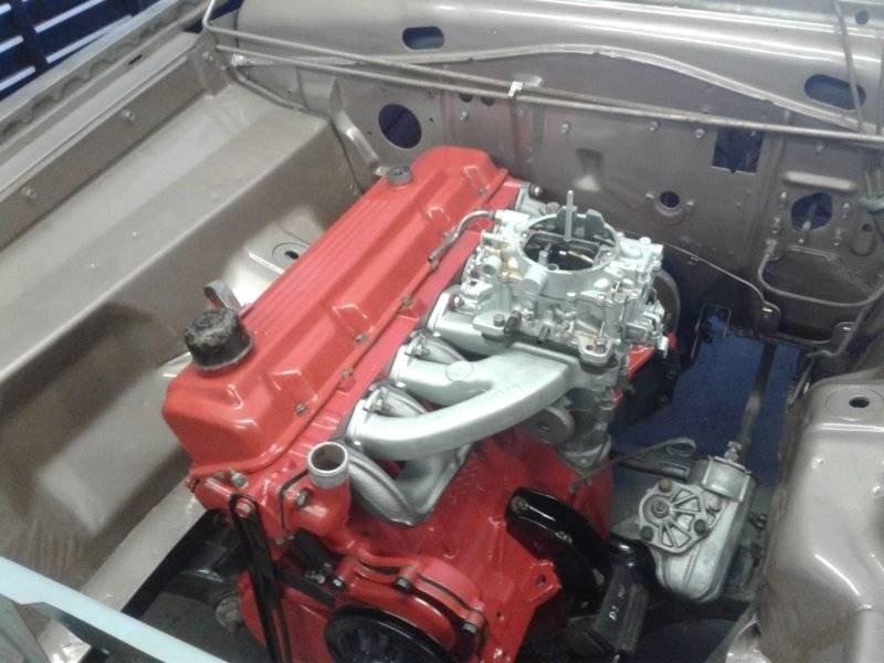

Engine & Trans are in their place. Thanks again for the help.
