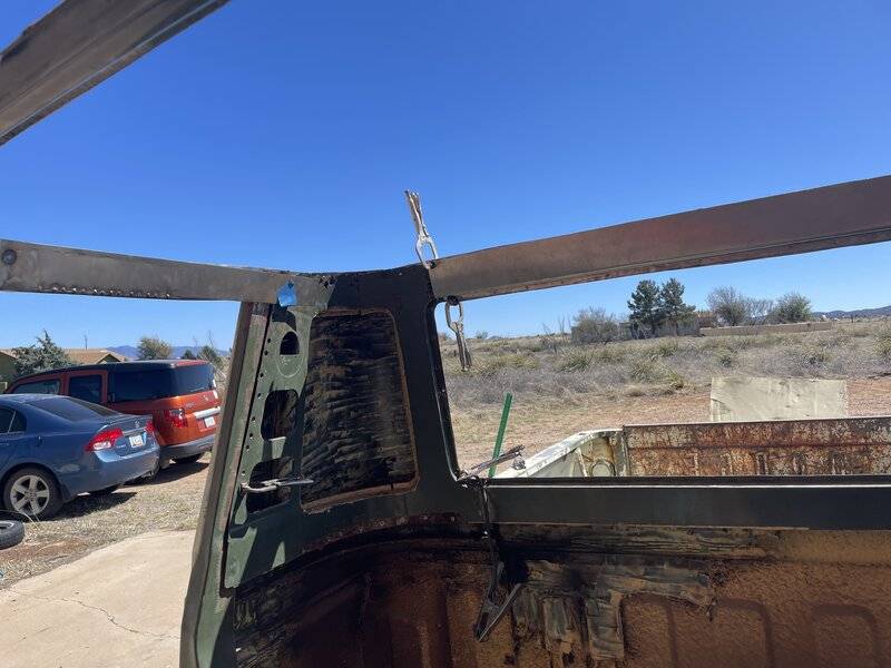

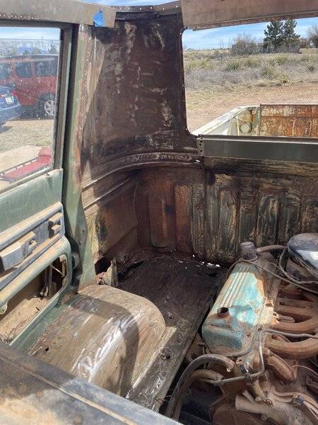

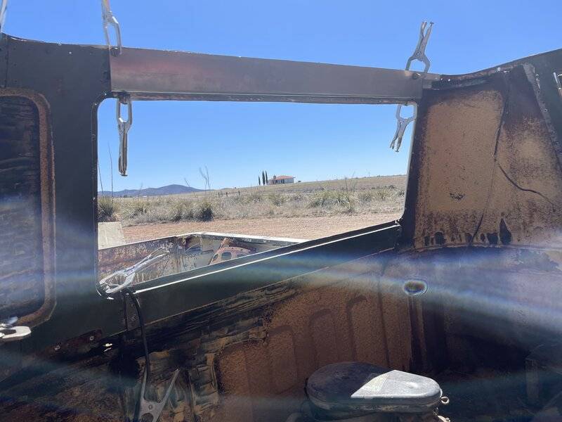

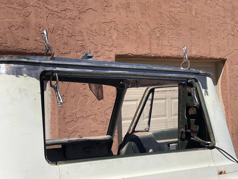

On the downhill slide. Ready to patch the inner trim panels and start fitting the roof skin. Wind, wind and more wind tomorrow though.

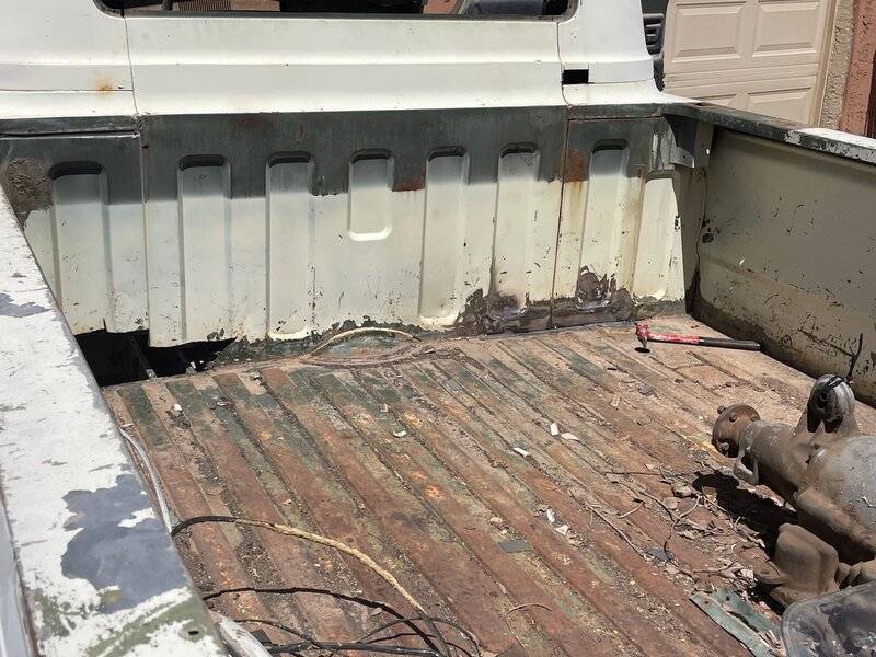

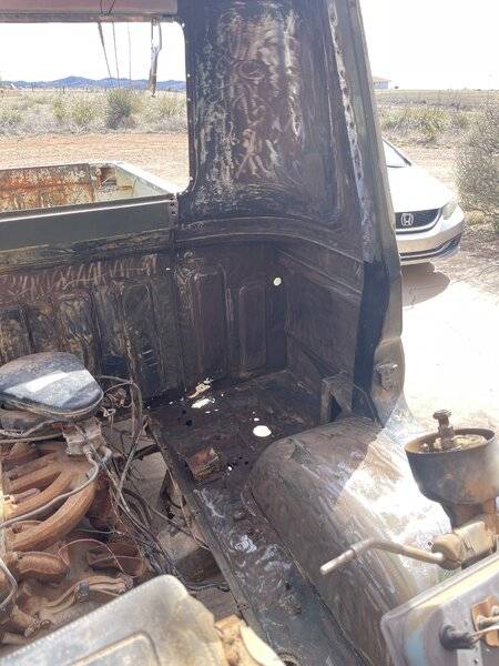

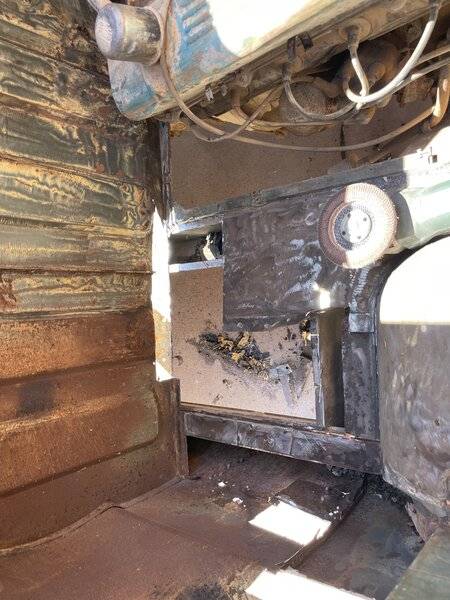

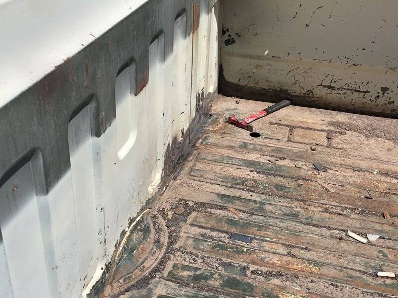

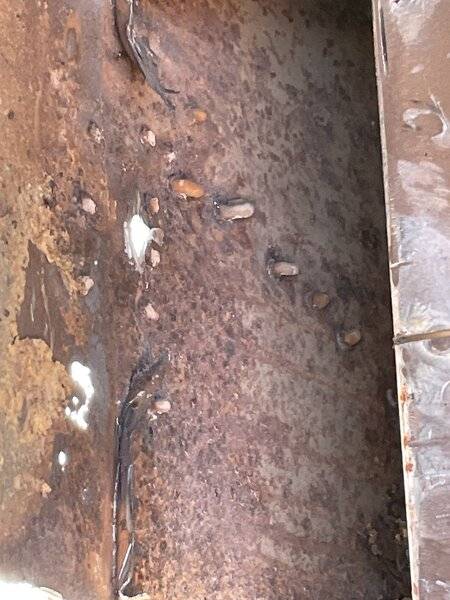

Six hours of stripping aftermarket spray foam and flapper wheeling rust and paint. Yeah….

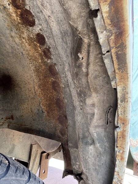

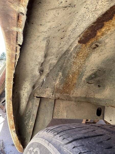

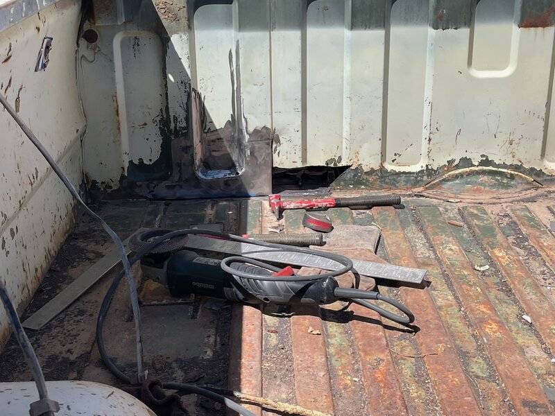

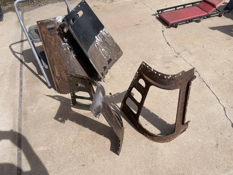

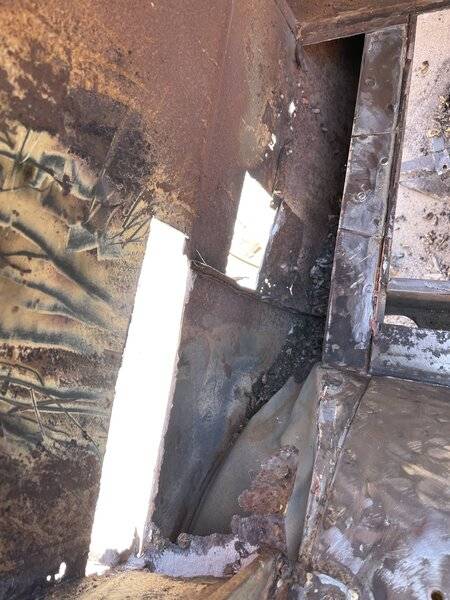

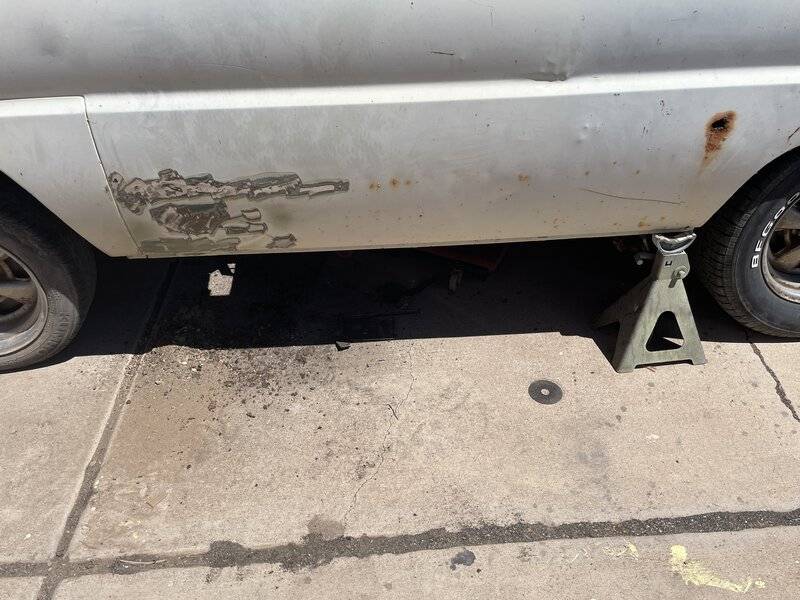

Well that sucks. The snowball is accelerating. It was hit in this side and sort of fixed by the same shop in Phoenix that probably put the quarters on the Valiant in the 80s.
Rusty metal removed and now I have to pull this front side to fix the inner fender. Sigh.

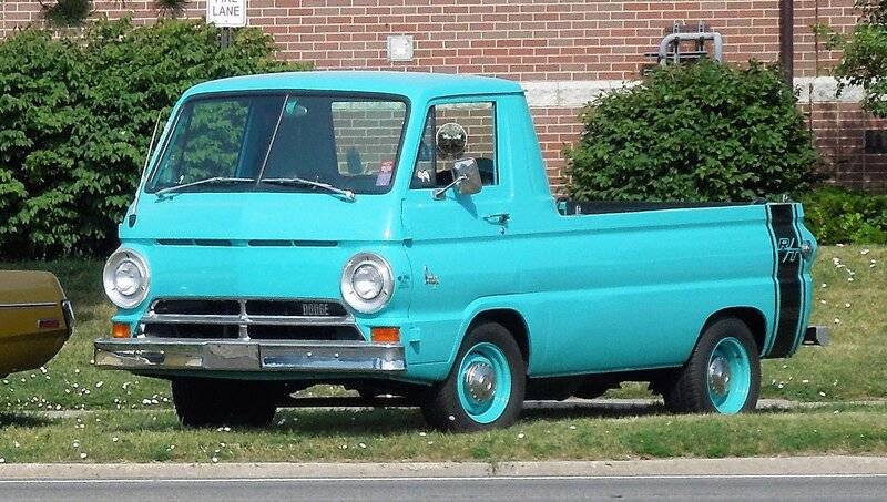

I knew a feller whos dad drag raced one of them in the 90s, thing had a 360 in it if I recollect...
This was my buddy's '65 A100. It had a 360, auto trans, 8 3/4" sure-grip 3.23:1

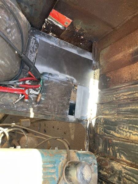

One side mostly done. Need to fix the exterior panels before doing much else. Drivers side bad metal is cut out ready for new patches.

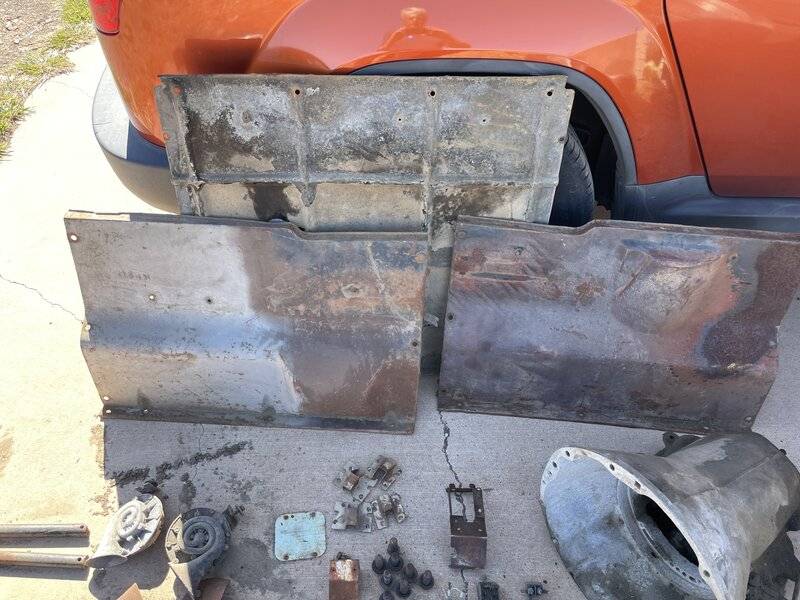

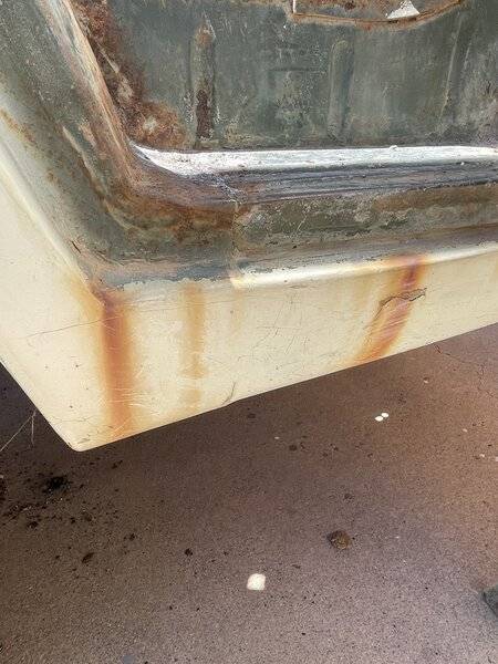

No question I am going to have to fabricate these lower sections or all this work is for naught.

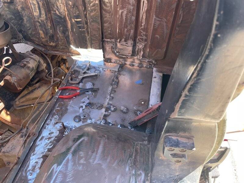

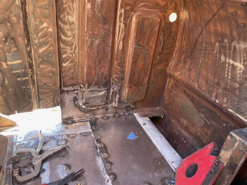

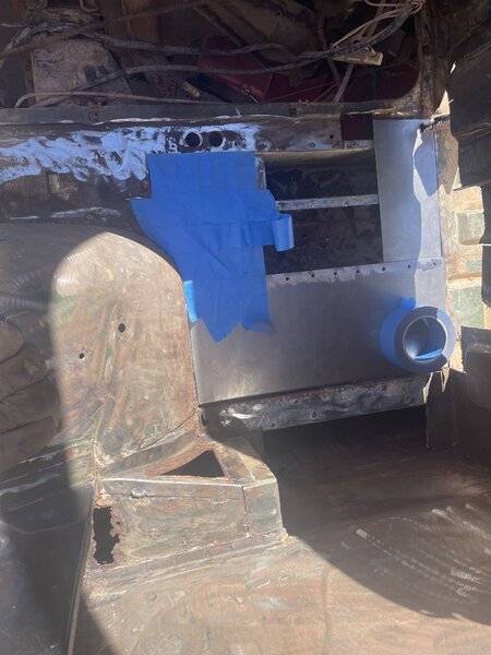

Few more panels fabricated and started to be welded in. Tape makes a great and accurate template. Need to install the battery box captured nuts positioned and welded in correctly first.
Time to stop when the welder runs out of gas... push it and pay with blow throughs and poor welds... just walk away and fix it another day.... Close though...

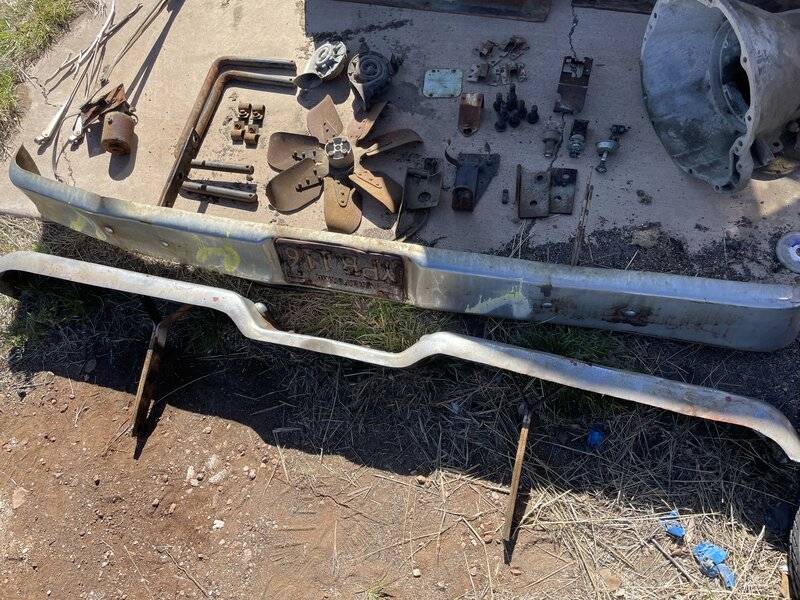

Play time is over I worked all weekend and kept seeing these amazing cars on Facebook lol! Looks like a hell of a time, now back to work :D.
Hey, it was a trip to collect all the missing parts. I need to finish the truck it was all work no play.
