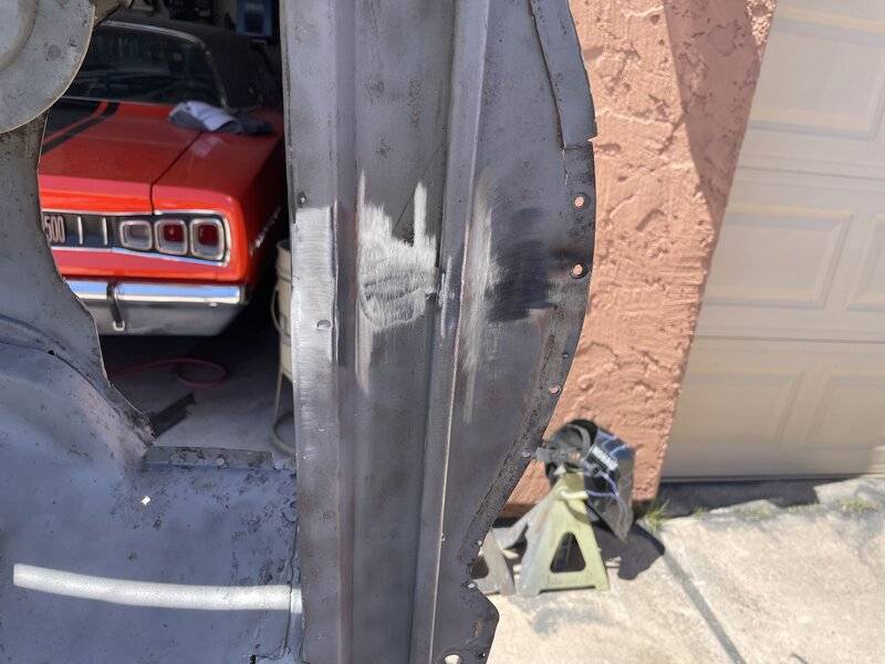

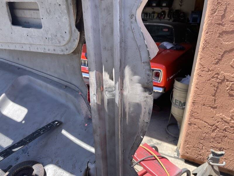

Corner post all welded in and the fender mocked up. The alignment is as perfect as one can expect! I was possessed by a welding great today. Some of the best welds I have ever done. Will work on getting the fender fixed and installed tomorrow. Dropping the mike and exiting stage right today.

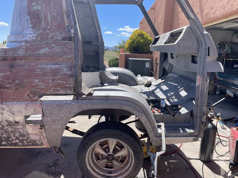

Inner fender is repaired and all tacked it. Outer fits nice but still needs some repairs from cut out lips from wide tires in its past. Door gaps look good.

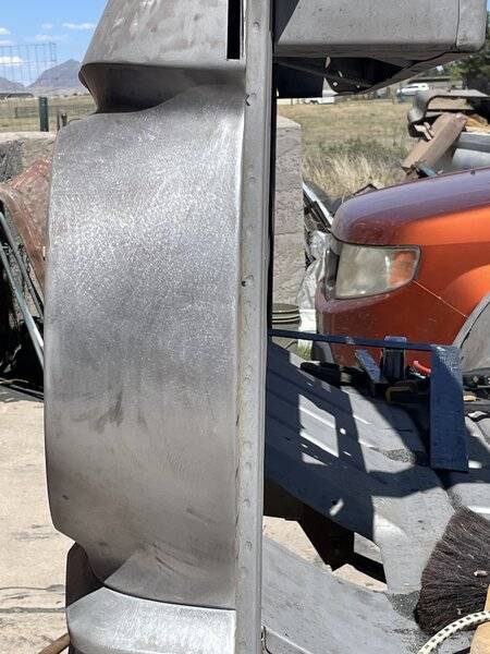

The used fender I got had been hammer rolled and the top is the lip was ground off. Needed to fix that. The fender is so much stronger now. Notice I left a small lip so I was not welding a seam and that lip ensures the shape of the fender does not change. Also reuse of old patches to save $$
Inner fender and foot step structure all welded in and backsides of everything epoxy primed. It will never rust there again. All ready to slap on the outer fender and get the headlight bucket skin fitted and welded in.
Outer fender and rear post “shoe” patched back in. Looking like it’s gonna work great. Next up the corner sheet metal.
