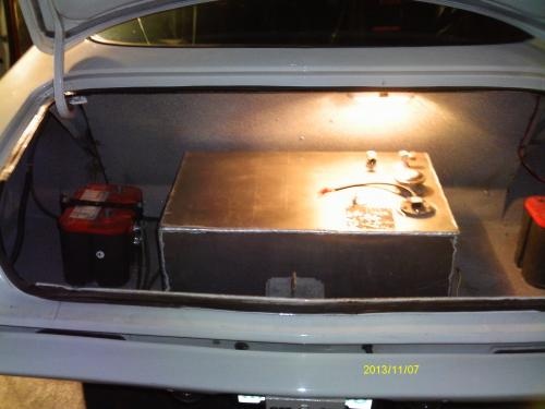

Too bad she's not like Teresa. Teresa says she likes it when I leave her alone and head to the garage.
