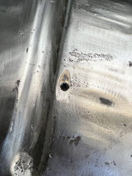

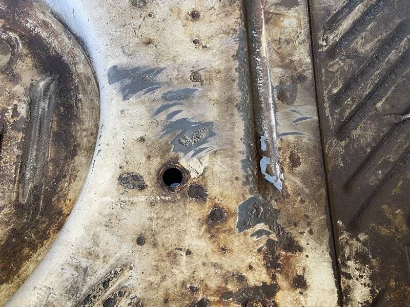

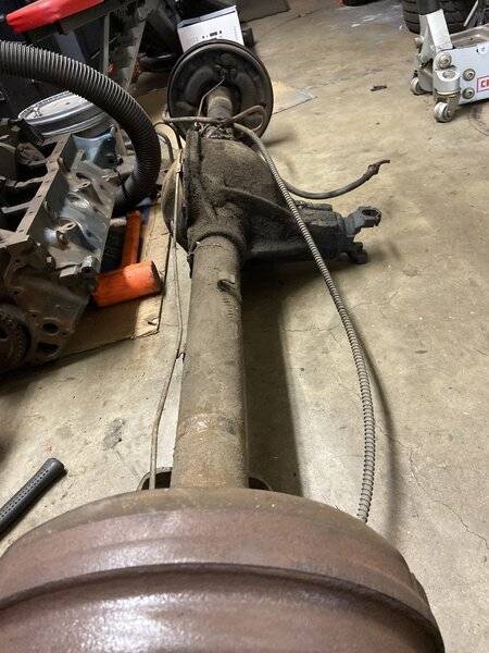

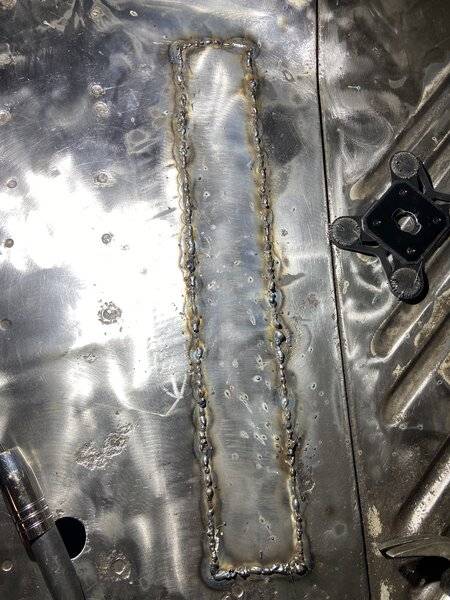

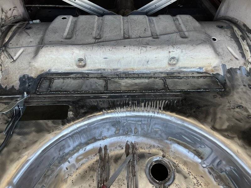

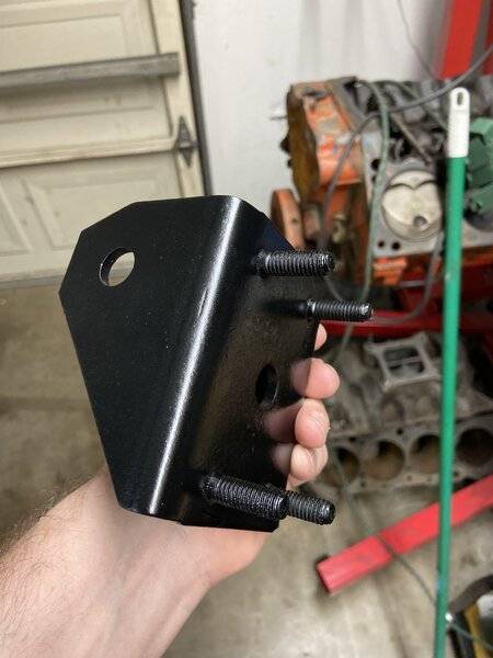

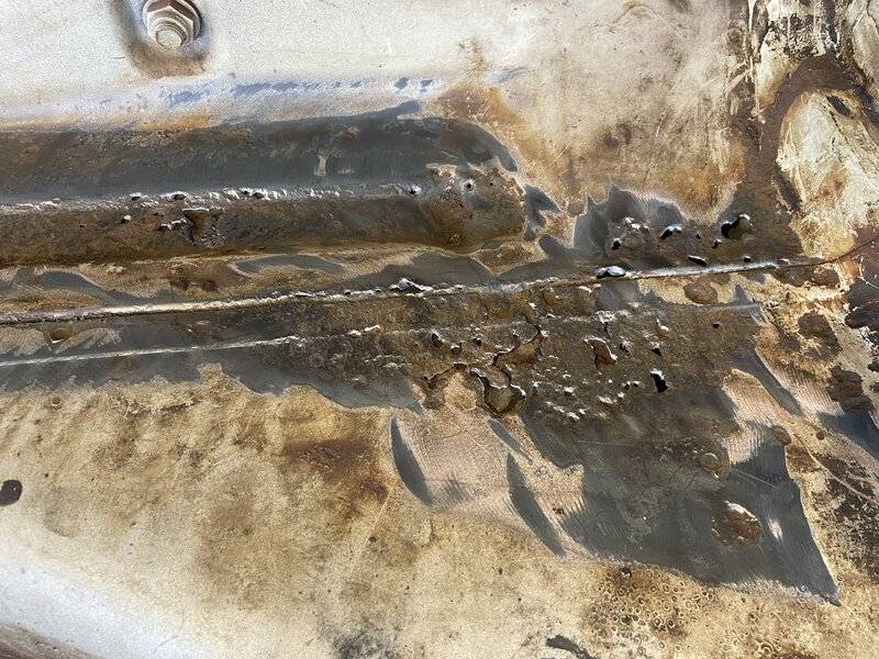

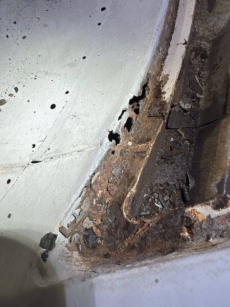

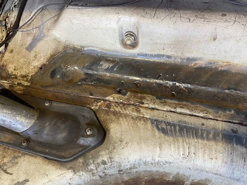

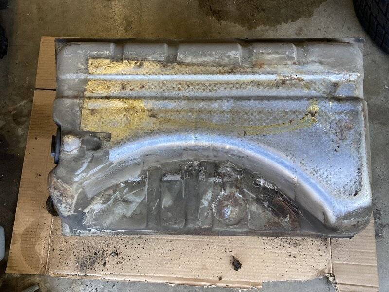

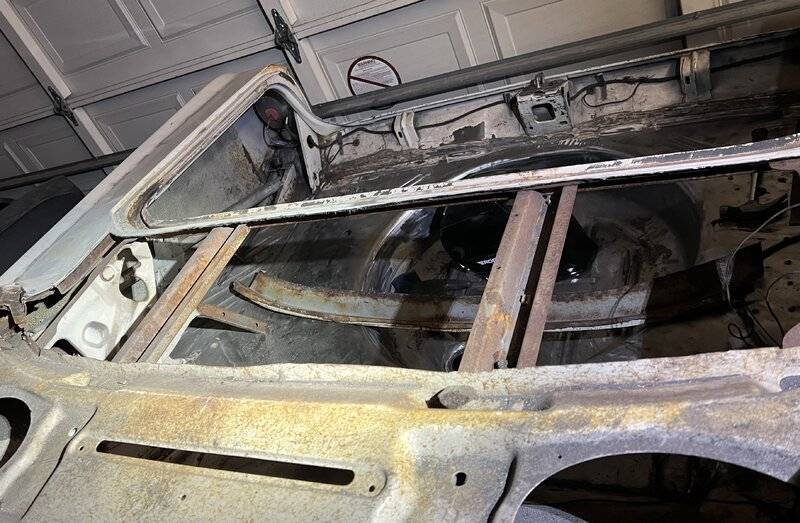

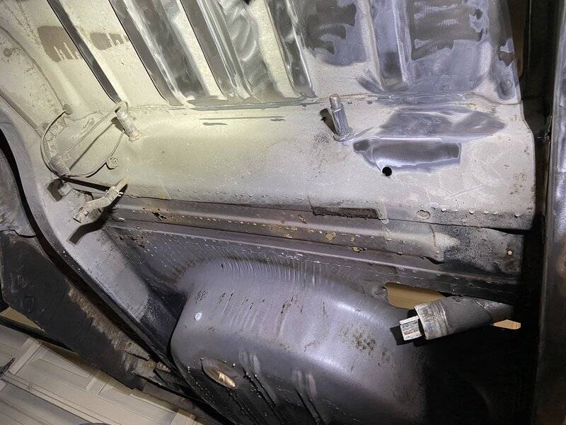

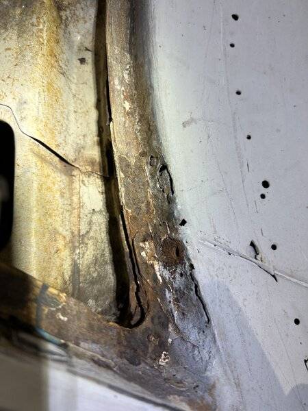

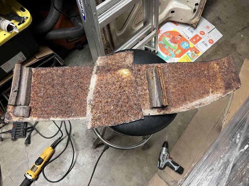

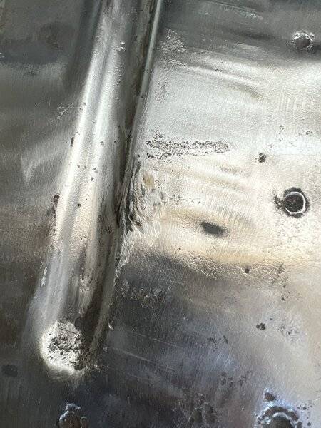

So, quick update. I’m waiting on my 8 3/4 3.73 sure grip to arrive so I pulled out the old 7 1/4 rear. I’ve been cleaning up the underside of the car, going to spray it before the new rear goes in. I might even drop the gas tank and weld up a couple small patches in the trunk while I have everything out.

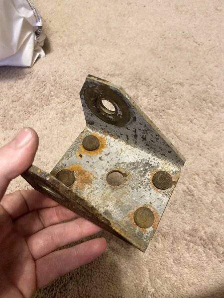

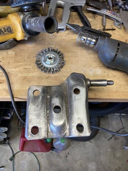

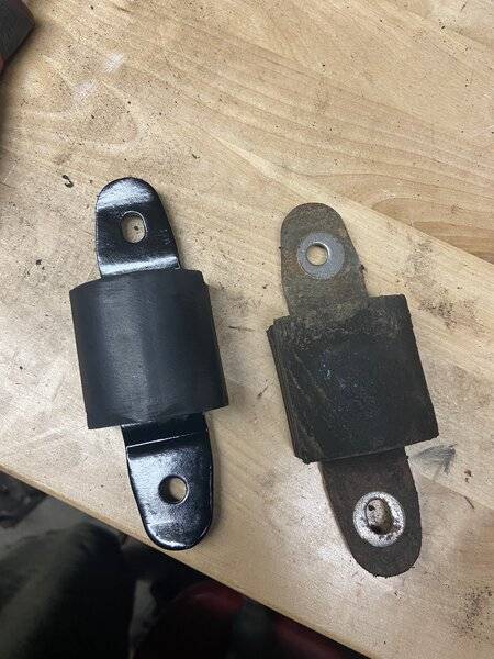

I’m also cleaning up and painting some smaller items like the spring hangers. My Espo 6 leaf +1 springs with poly bushings/shackles arrived. Going to pair them with my Hotchkis rear shocks I have sitting here.
