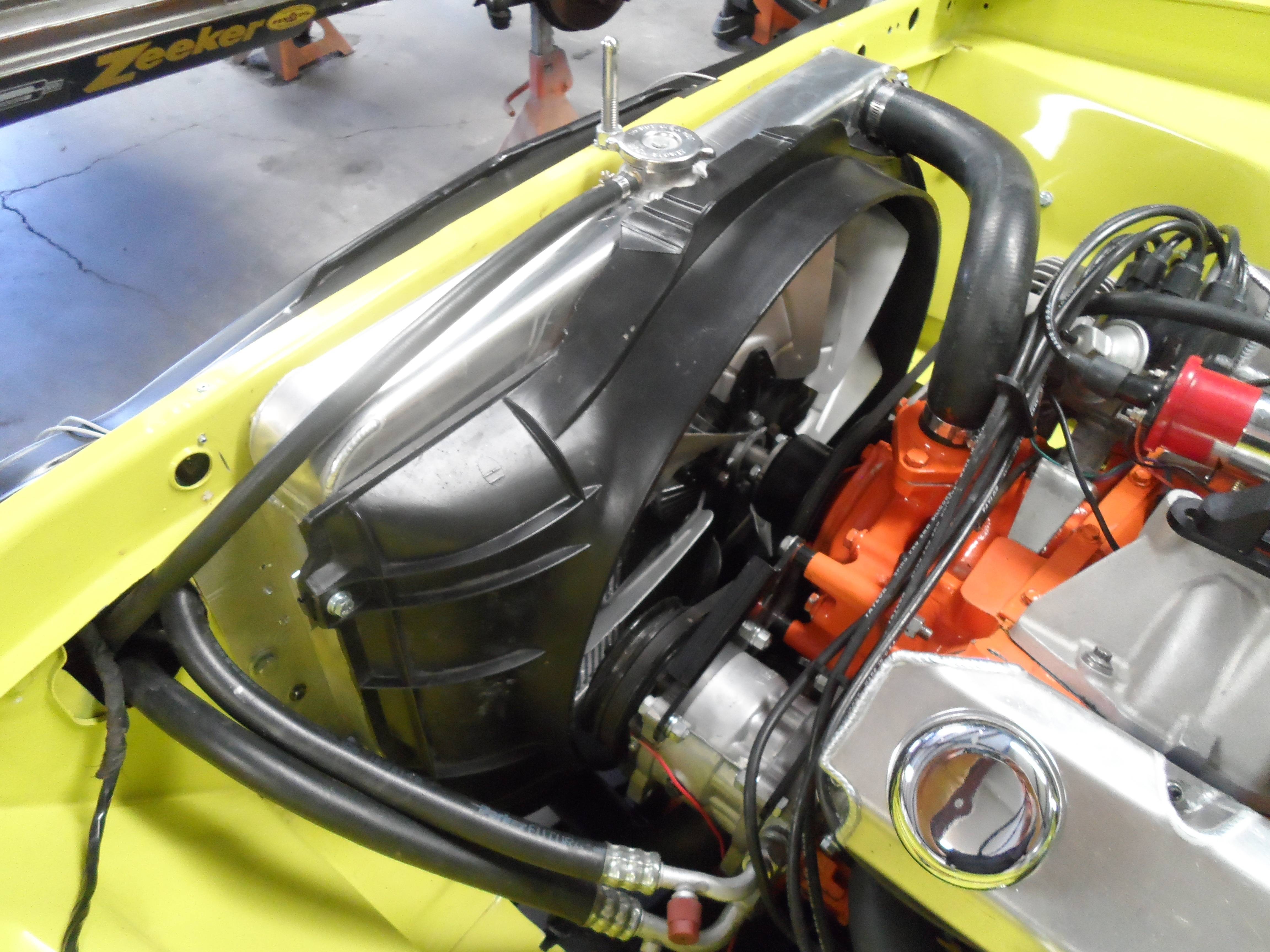

Thanks a bunch Stephenf. Do you have a thread? I would love to check out your car :) I posted some new pics of my current cooling system and I was able to use a factory B body fan shroud. Looks factory. I am really happy with the cooling and the looks of it :)
