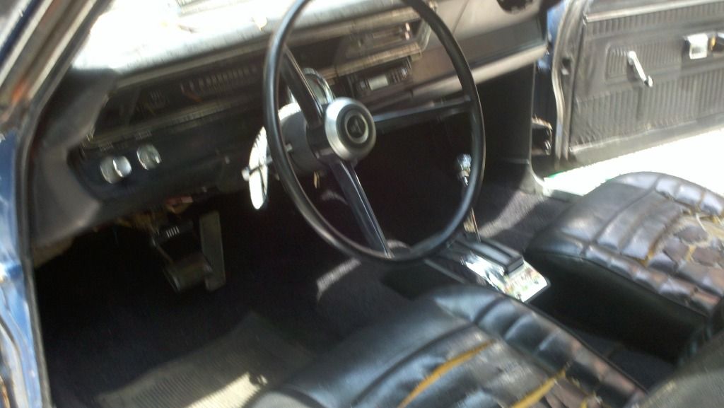

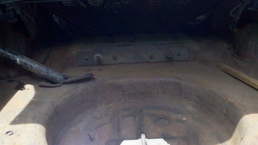

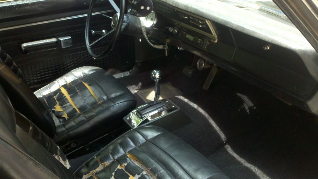

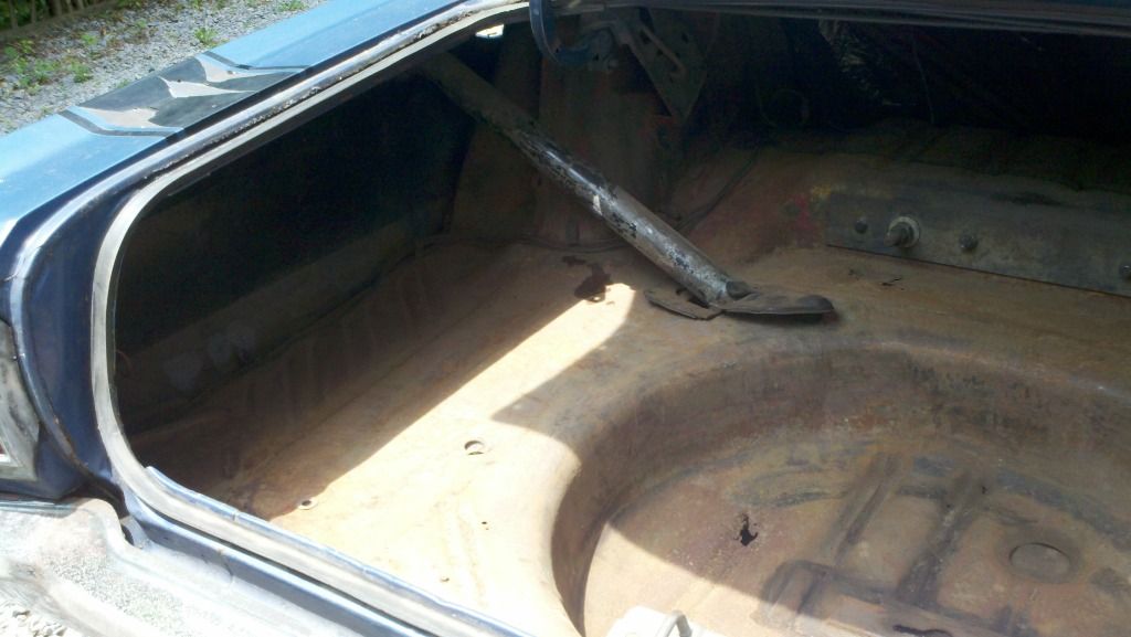

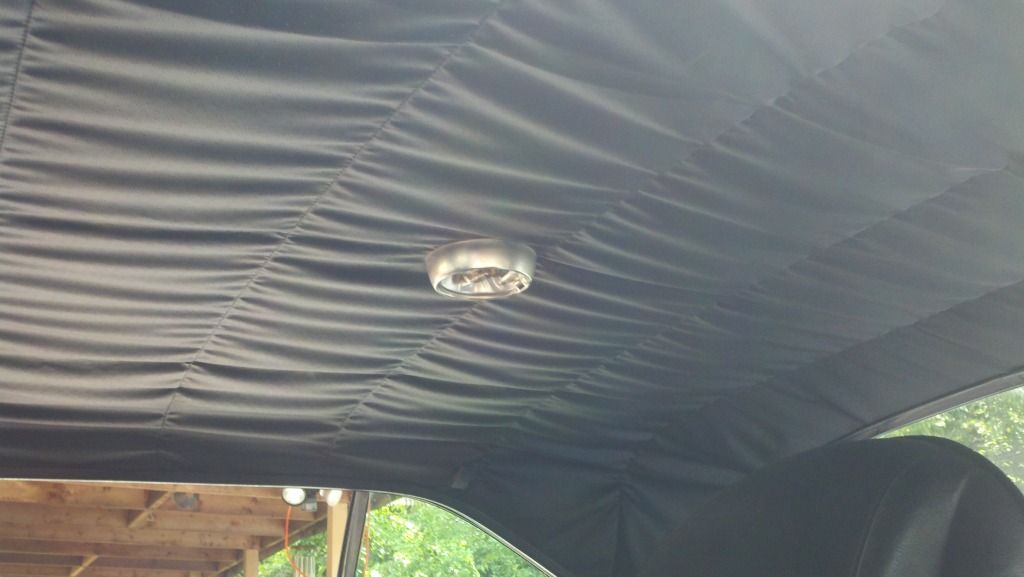

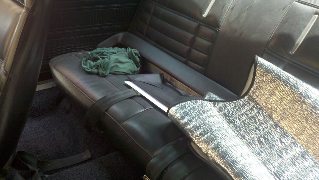

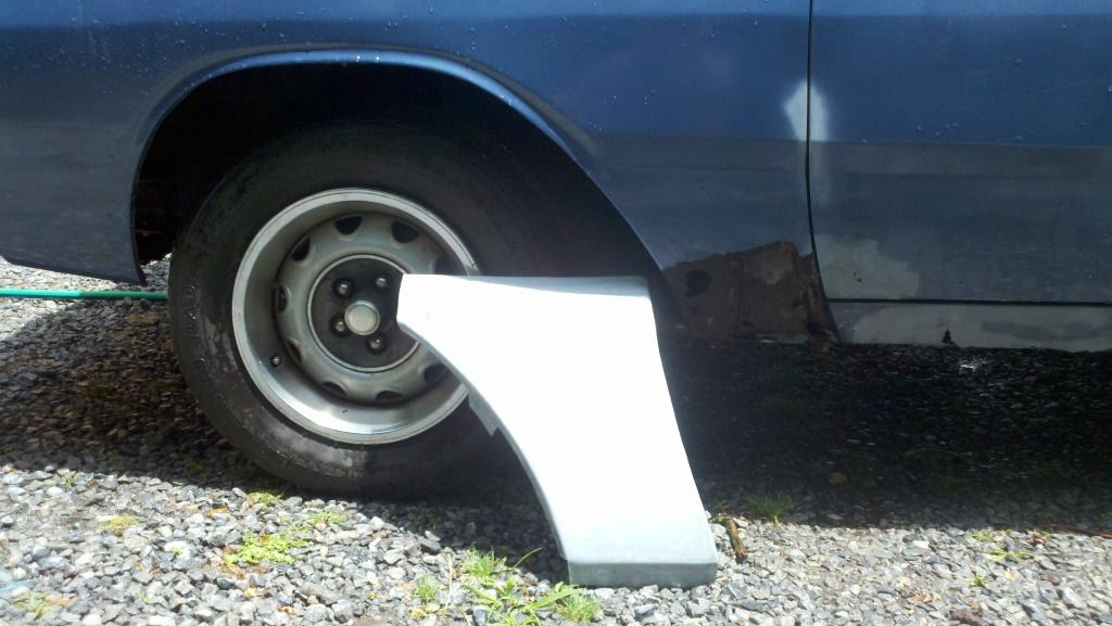

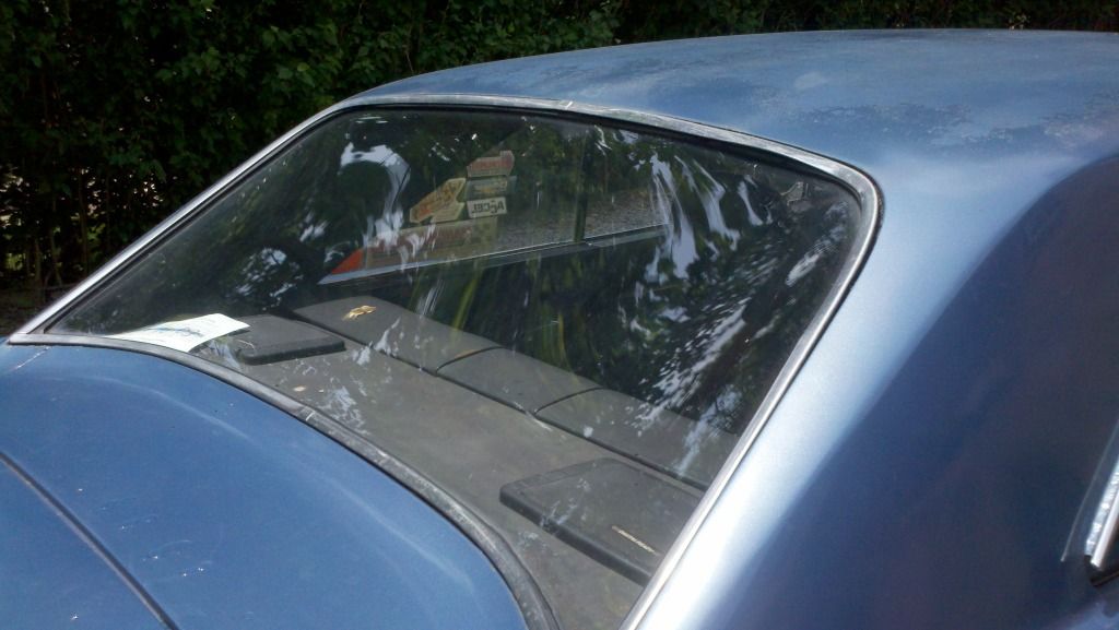

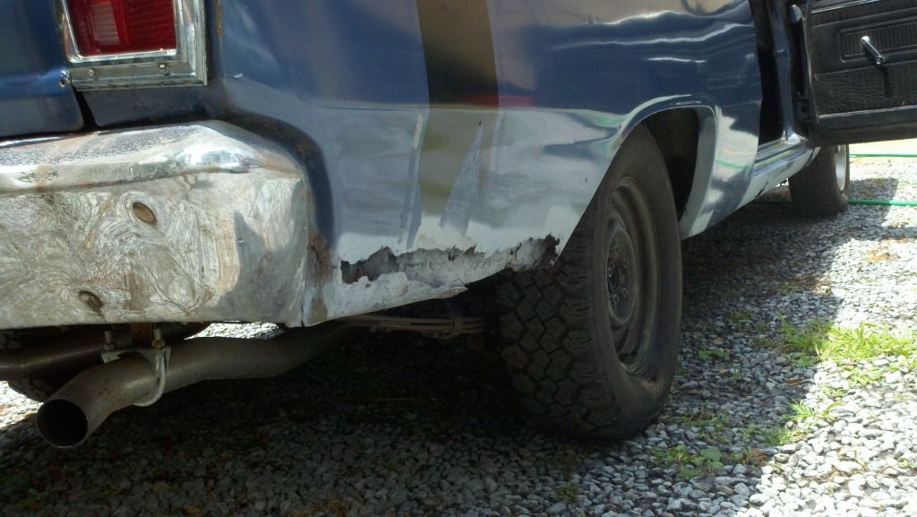

Unless you are good with rust repair, I would not get it. Also the engine with that date code would be correct for a 1970 model year car not 69. The headliner was not correctly installed, there is rust on the rocker and the door opening below the fender. The seats are wrong and it needs a spare tire well. What is going on where the shocks mount? With all that said and you still want to get it, I would put the value no higher then $3,500.
Quaters are off a '67, needs spare tire well, trunk extensions, quaters, marker lights, rockers, maybe doors, inside the doors in the body seam couldbe rusted out also, filler neck gromet, correct seats, headliner, 340 block, wheels, package tray.
No higher than 3500
What are the seats out of and what year?
I didnt even notice no side marker lights and quarter panels being wrong.
I'm not scared of putting panels on but I dont want something so far gone to be fixed it would be a nightmare.
Do they reporduce the marker lights?
What do they not reproduce for this car?
this car needs ALOT from what i can see. have you looked under the carpet at the floors? how about some pics of the engine bay and frame rails. i can say with confidence you will have a ton of metal work ahead of you. if it were me, i would keep on walking and find a better foundation . they are out there , you just have to be patient. think about it, both quarters, rockers, trunk pan , possibly the floors , and we havent seen the bottom yet.
Yea, what everybody before me said and just to add, that's a far cry from the Duster you were trying to trade for. A ton more work.
red with white stripe and black interior - bench seat. also from above mentioned -GTS hood and tail piece? I noticed the upper inside doors do not have the GT Sport emblems. are the core support and trunk lip stamped with vin?
Some serious work to do on it. what do the frame rails look like?
it seemed from the first question whats it worth and what will it be worth? you'll be upsidedown in this unit. I agree keep walking and find a more complete project they are out there.
