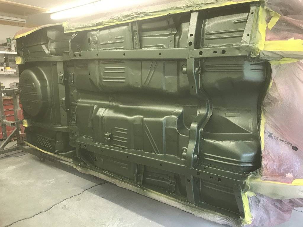

I saw that bottom picture and was going to ask if you did a black base coat before the green. I too like the others never really liked the green but seeing it fresh definitely changed my mind. I guess the ones you see faded don't show it's true beauty. Your car looks beautiful!
How easy was it to paint on the rotisserie? Did you rotate to do the top etc? Have you painted inside the cabin yet? If you did I must of missed that picture.
Again, you do great work and the car is looking awesome!
We actually ended up putting a darker gray base coat on after about 5 coats of paint since the green wasn't flipping dark then put about 3 coats on. We allowed it to dry out overnight before applying the last few coats.
Yes I flipped the car around as we painted it. Had to make sure it was clean and taped shut so stuff would fall out from inside

Got the bottom undercoated and decided to paint it body color. Going to clear it tomorrow night.

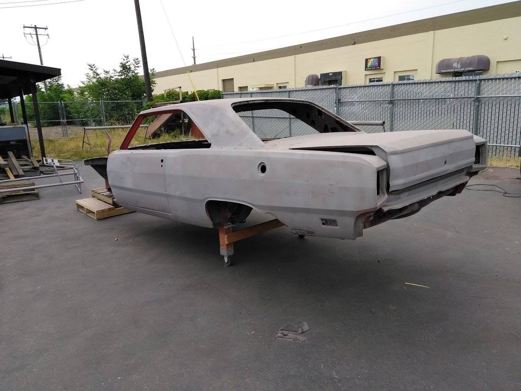

Got back from Nats and got the car on the ground and test fitted the 295/50/15's so I can finish welding the wheels up. I've also got all the parts cut in and wet sanded ready to paint sometime this week.

Well... glad I didn't doubt my painter. It all matches well and metallic is flowed out the same. I can't wait to get it wet blocked then polished but I think I'll hire that out. I'm tired of sanding and need a break.
