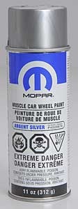

I'm going to take a crack at restoring the grill on my 69 340 Swinger. Can someone tell me correct silver paint that goes on it and where I can get it? Also is the black a flat black or satin? I haven't found an earlier post about it and I'm hoping someone here has done this before.
Thanks a lot!!

The correct Mopar color is called Argent Silver P4529876 its also used on wheels and silver consoles
