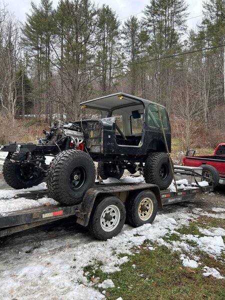

Welp, finally got the YJ/CJ build together to the point I'm waiting to be able to paint the tub this winter, so the jeep got swapped out for the duster! Time to yank the engine back out and see what's going on!
Getting the duster on the trailer with slippery snow tires was fun! lol but I got it. We got rain the last few days so there was no salt on the roads at all. Thats why I was really trying to play musical vehicles and get them swapped out this weekend.

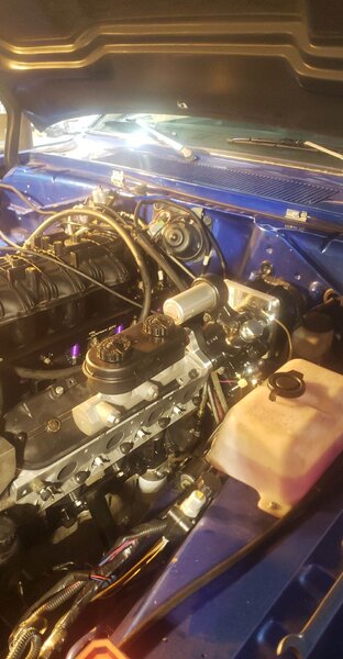

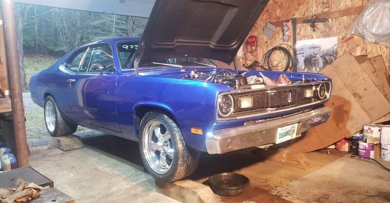

Finally got the car back together and out of the garage Sunday! She runs!! And it has great oil pressure! The tolerances are opened up to the .0025 that they should be and still have about 50psi at hot idle with 10-30. Drove the car to work today as its first test drive after bleeding the clutch last night! Driving the car around the oil pressure is up into the 70s as well! Haven't done any WOT pulls or even got into the boost yet, just letting the rear end break in with the new gears. She runs good though! I'll also say, while the car was down, I threw the manual master in the trash and put on a hydroboost system from Hydratech and its AMAZING. The car finally stops SO WELL! I couldn't be happier with that! Here are some pictures!
