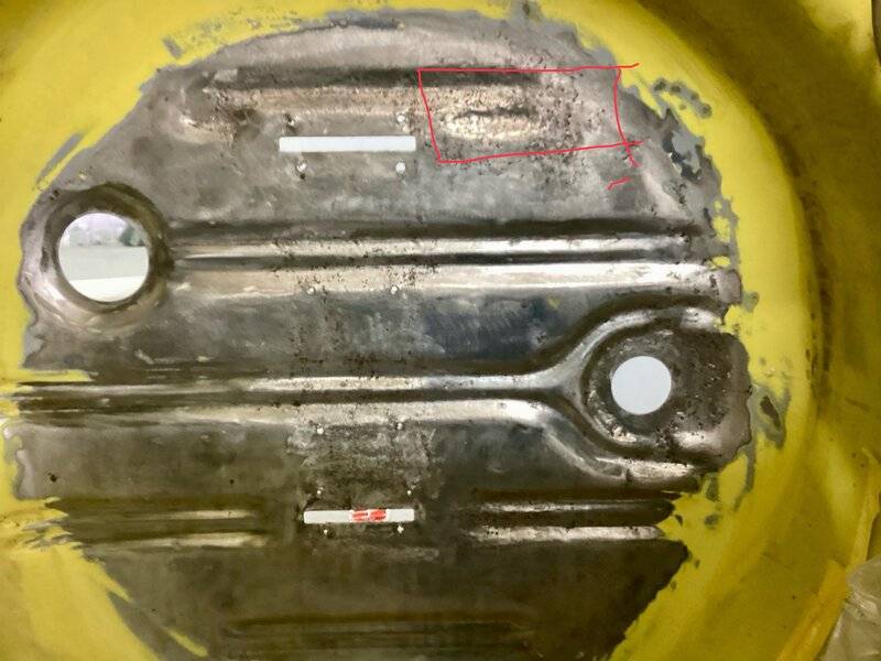

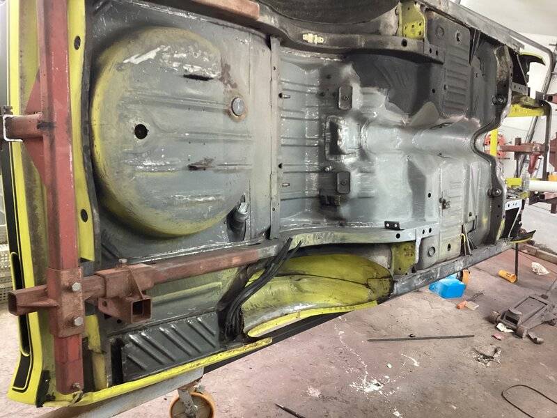

Just started restauration on a clean South Carolina car , so far pretty impress no rust to speak off just remove all undercoating from bottom heat gun & scrapper about 50 hr Cleaned residue with brake cleaner need repair on frame rail where hoist pad go bent in small repair need on rt 1/4 rocker seen in red

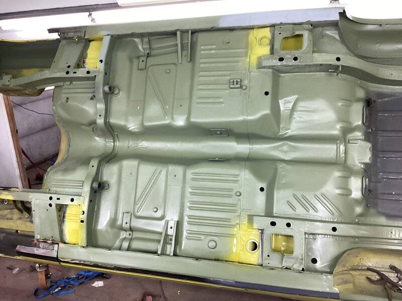

Just update last few week , finish cleaning underneath install torque box oe style. Primed underneath had few pin hole in truck area was able to weld . Will reweld brace this week.
