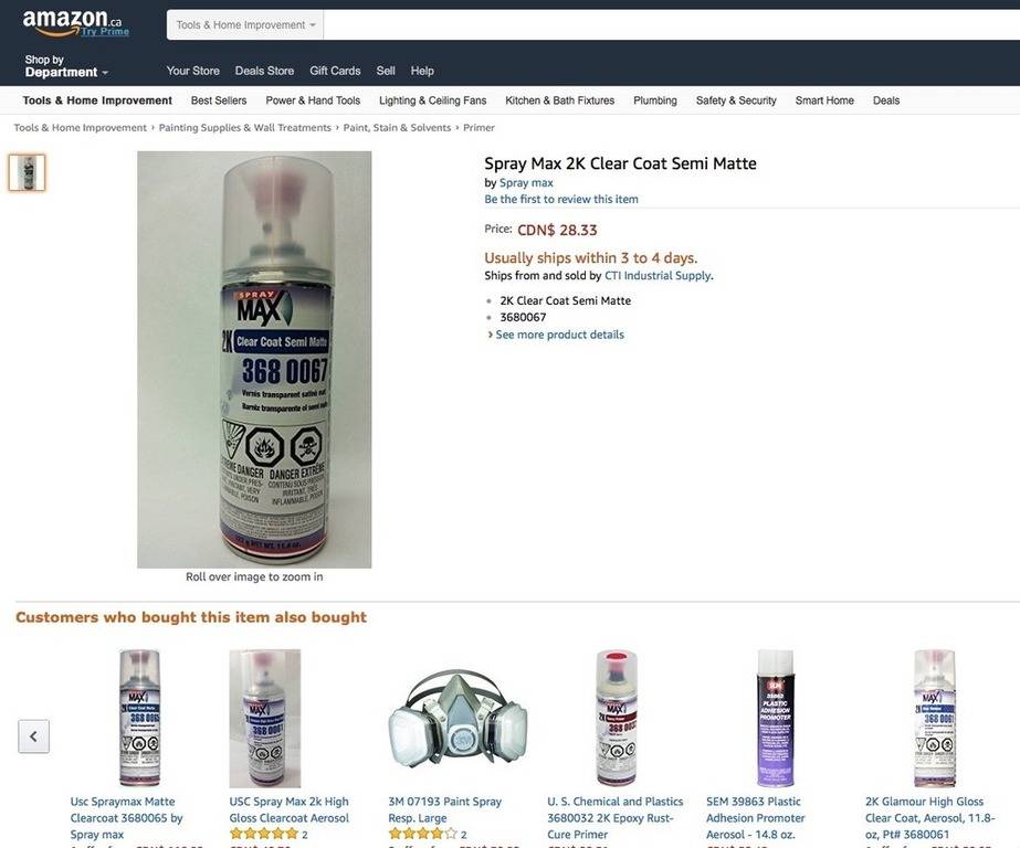

One more question, the Matte clear. Spray bomb? Concerned about comparability with the fiberglass.

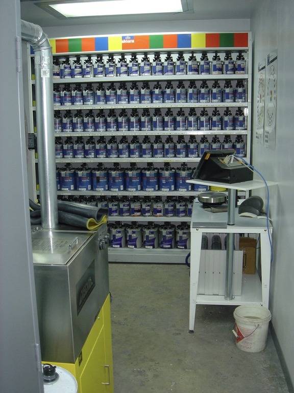

On the clear I have a significant advantage over most in that I have a fully stocked Paint system at my disposal,
But I'm going to suggest, and this is the product I would use myself if I did this at home, a product call SPRAY MAX, in this case Spray Max 2K Clear Coat Semi Matte (not the straight Matte version). This is a two component clear so it has a hardener capsule inside the can that you pierce by putting the red cap you see in the lid on a pin on the bottom of the can and slamming it down to drive that pin into the hardener activating the clear. You have 24 hours to use the clear then it will be spent and won't spray anymore. These cans spray very nicely almost as good as a minijet spray gun but one should do a few test sprays on something and this will also show you how quickly it dries and it cures up pretty quickly which is perfect for home spraying. Now this is a professional product so most bodyshop supply stores should carry it but you can buy it on Amazon.ca and our U.S. members can definitely get it on their Amazon. It will work perfectly on fibreglass all you need to do is provide the proper sand scratch for it too grab onto like all paints. I used some degreaser first then a red Scotch brite pad since they work great for getting into all the nooks and crannies then I wet sanded the boxes with 800 grit then blow off and degrease before tag ragging the surface (use a nylon lint free tack rag if possible). If you get some of the fibreglass fibres standing up let the clear dry for a few hours then degrease then re-scuff with 800 grit (you won't need to rescuff every corner since the clear will stick to itself without sanding within 24 hours but you should degrease which removes an invisible film that most clears produce while curing) too knock them off then degrease and tack off and re-clear, this procedure should give you the same finish that I achieved.

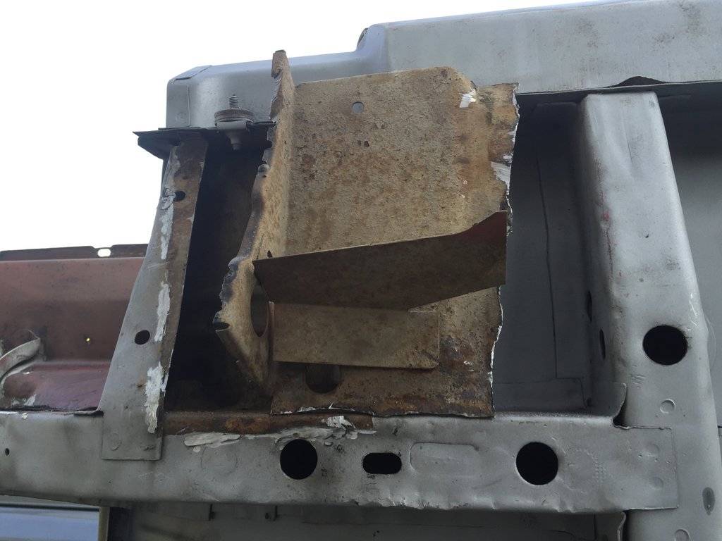

This is kind of the last opportunity to find any fitment issues and correct them before blocking it all out. Unfortunately when I replaced the quarter panels I forgot to test fit the rear valance and it doesn't fit very good on both sides,
the AMD sheet metal did give me some fits with fitment and I'm not sure whether I could have done much since the trunk drops didn't allow me to move the bottom of the quarters any more then they are. So the fix will have to be, and likely would have been, to do some cutting and altering the valance which is the easier panel to work on. Just wish I had of spotted this before I did all the body work and priming the darn thing, the front won't give me this problem since the front end sheet metal is all original.
View attachment 1715065432 View attachment 1715065433
Tomorrow out comes the body saw and the welder.

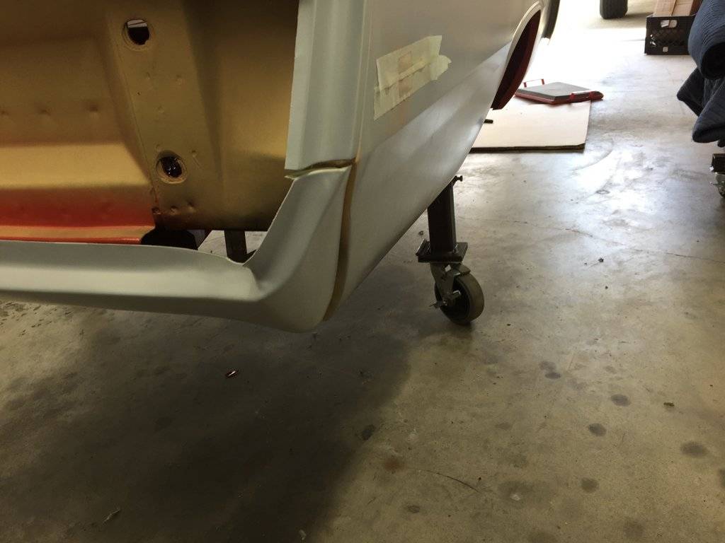

Addressed the issue of getting the quarter panel extensions and mostly the rear valance to fit the AMD quarter panels properly, I was able to coax the left side, using some strong arm tactics, to line up pretty good so then I would only have to cut the one side.
I started out making a relief cut down the body line on the side and removed a couple of millimetres until it lined up properly too the body line on the extension then welded that up,
Then I made the cut that will allow me to spread the two half's out so they line up with the lower quarter panels. Then I needed to add some metal to the end section,
Fasten it back on the car where it fits properly then I can find and mark the line to be cut and weld the two sections back together and apply some All Metal and filler. Fasten it back on to check the fit which is much improved,
Then some more work to fine tune the fit between all 5 panels to get the gaps correct that everything flowing into each other correctly,
Everything lines up nicely so now they will come back off for priming blocking and painting and since I know they did fit they should go back on looking proper.
I wish I would have had NOS panels which would have saved a lot of time with fit but I'm still really glad AMD made the panels I needed since thats one of the big reasons the car sat unrestored for so long, anyway this area is not an issue any more so onward and upward!

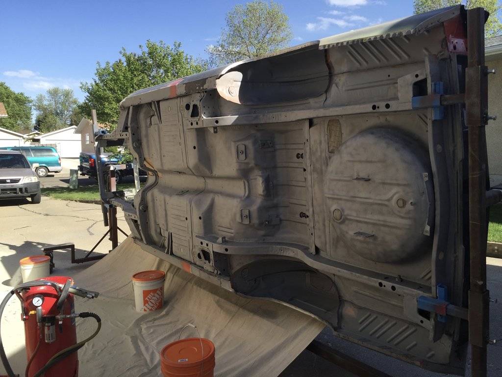

Danny,

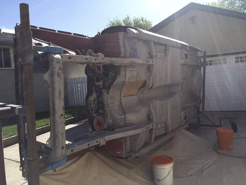

I seem to remember that you sandblasted the underside of your car before painting it, but can't confirm cuz the pix are gone. I am about to start blasting mine. I have gone over as much as I can with a knotted wire wheel on an offset grinder to clean everything up as much as possible first. I have a 40# pressure pot blaster and will be using ground glass media for the blasting. Do you have any recommendations from your experience on how to attack this beast? Might as well try to avoid reinventing the wheel. I am thinking that I will try to get the boxed in areas like the spring mounting pockets first and leave the flatter, open areas for last. Whutcha think? Thanks. L8r
Jim
Sorry that my thread and pictures are messed up Jim, I took the approach of not wanting to spin this thing back and forth so I hung a canvas tarp off the car so it would catch most of the glass so I could easily gather it up and reuse it. Then I worked from the bottom up and blasted everything I could see at that end of the car then moved the tarp down and did that end, spun the car around and flipped it and did the same process from the opposite angle, I did wire brush it by hand to knock the bulk off before I started. I took some breaks to give my compressor a chance to cool off and me as well. I decided to remove my torque boxes and rebuild them to remove the dents and clean up the poor welding the factory did bonus being I could blast and paint the inside of them. Later I decided to blast the engine compartment and fender aprons, since I was this deep might as well keep digging LOL! I think I managed to blast the whole car using 3 or 4 bags of glass, not a fun job but the only way to clean it up right.
View attachment 1715079023 View attachment 1715079024 View attachment 1715079025 View attachment 1715079026
Danny, this is very helpful information. You did exactly what I am intending to do. I was curious about the amount of media you needed. I guessed and decided to get 6 bags to start, so it looks like I was in the ballpark. My intention is to just do the underside, but if I have enough media (and patience) I may do the outer side of the engine compartment and lower radiator support as well. I am fortunate that this car is VERY clean, so I could easily get by with a wire brush attack on the engine compartment and aprons if I decide I have had enough of the media getting everywhere the sun doesn't shine! Thanks for the quick response. L8r
