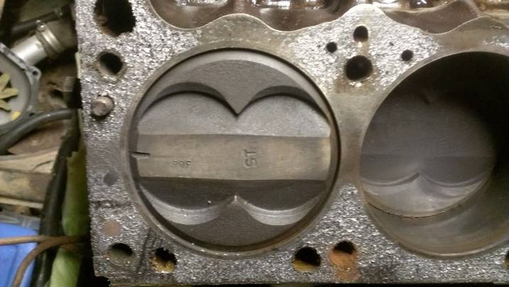

The low compression 340 pistons will have 4 valve reliefs similar to these:

Will check the pistons probably next week and report back. I hope ist HP as RK Motors claim, that would make things so much easier and more affordable I guess...

did you ID the pistons yet?

Looking at balancer i can confirm its a steel crank engine, it has J heads on it also.
I wanted to see what cranking pressure it generates.
If that says nothing we will pull the heads.
