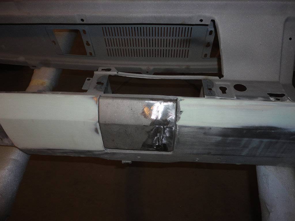

The last step that was holding up filler work on the dash was the stereo. As I mentioned, I had no intentions of using the Barracuda thumbwheel AM radio in this since it's a daily driver and I'll need more than that. And since someone trashed the dash to make the AM radio fit, the place to start was the plastic dash panel.
I picked up a 1/8" sheet of styrene to fill the void:
Then to figure out how much damage I was going to repair:
Then I had to get the stereo. I went with a Sony that has the jack for my mp3 player and SirriusXM. With that dry fitted I determined what needed to be filled and glued the pieces in with JB Weld:
I also embedded a wire across the bottom to give some really brittle plastic some strength.
With this done I was able to make some brackets, fit the stereo and weld the brackets to the steel frame:
And with that done the filler work finished right up:

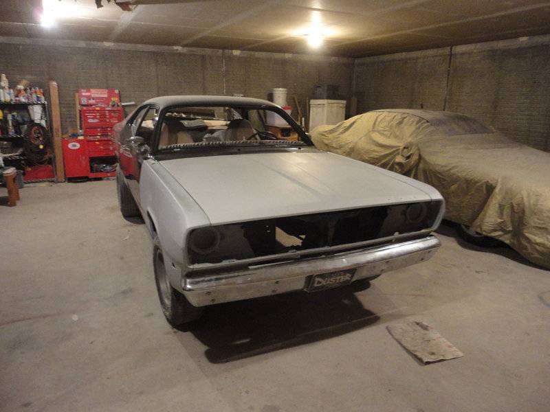

Dry fitting sheet metal:
Not happy with the hood gap. The doors are as far back as they can go and so are the fenders, because if they're not the fenders stick out past the hood on the front. The hood gap is better than 3/8" and I was hoping for something shy of 1/4". But. Other than the straps that hold the lower fender fronts to the bumper mounts (buried in a box in the trunk) everything is bolted down tight and the width of the rest of the gaps is pretty acceptable.
When the time comes I'll start blocking these out while they're on the car.That will catch any anomalies where the fenders meet the hood and doors. I haven't noted much yet but it would be foolish not to when I have the chance. Meanwhile, I'm looking at reconditioning the tail lights and grill.
