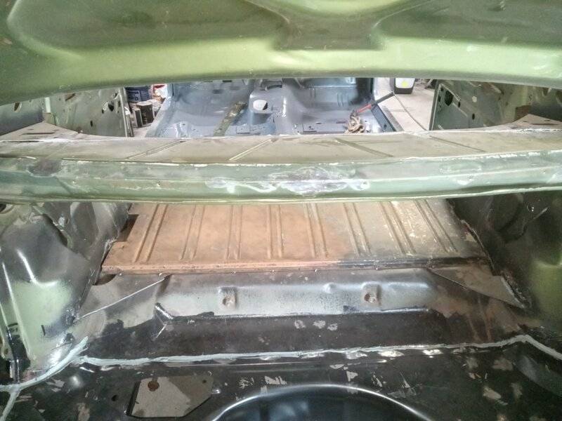

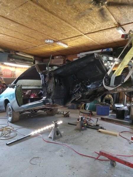

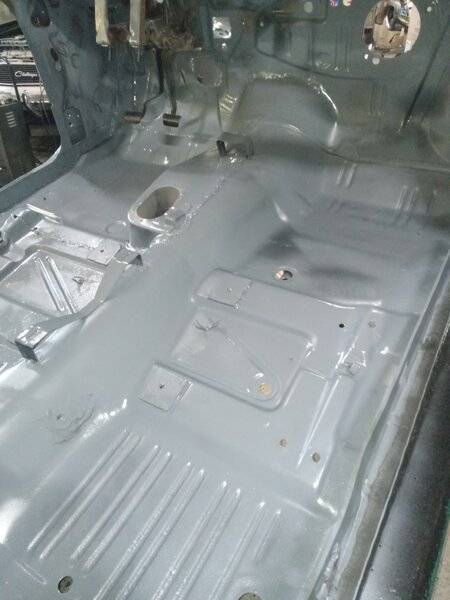

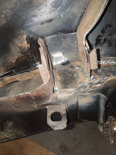

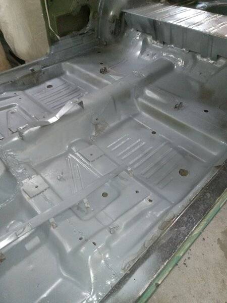

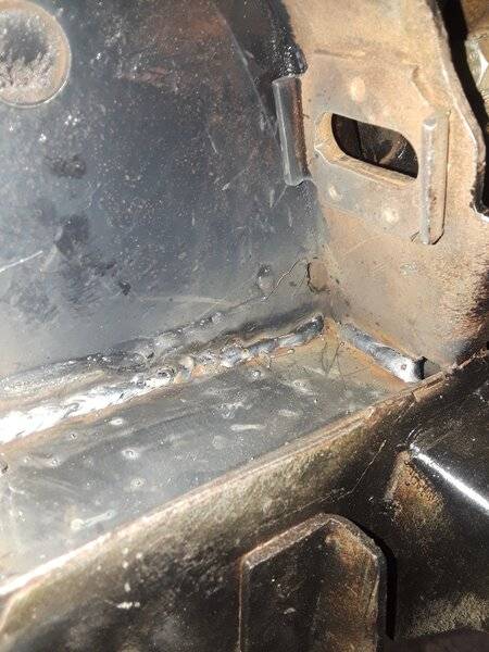

Got some plates welded in top frame rail under cam bolt areas , looks like it will be solid an strong , used 1/8 plate

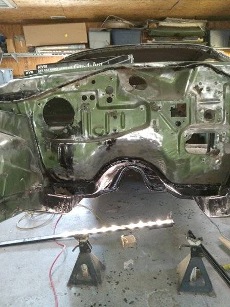

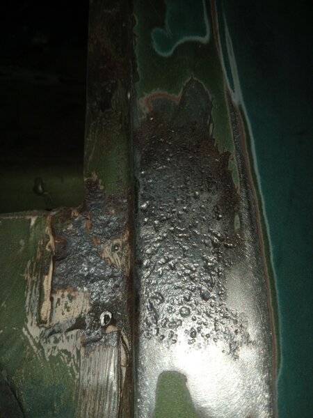

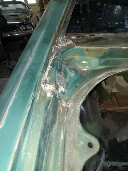

Yea its ready for me to start lead welding the rear panel an one area at windshield area , then sand an primer , hope to get started back soon , wife doing better but busy with the full time job ,

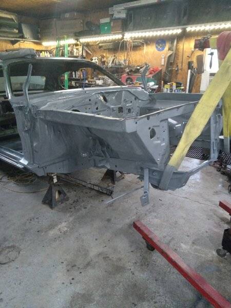

Finally getting some work done , finished cleaning bottom of pans , hope to spray primer on firewall soon , hope to get color on firewall and get motor/tranny installed with kframe an front end , hopefully before end of Sept.

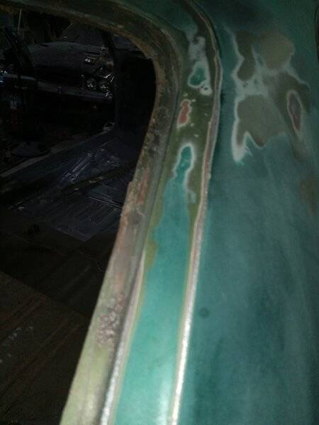

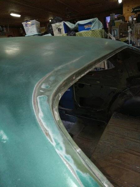

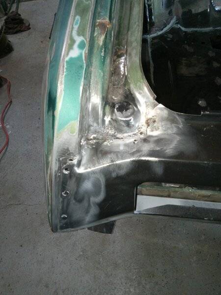

Finally pulled rear window and found it to be actually quite solid , some light pitting here an there the worse an not bad was lower right an top of panel on passenger side , but only pitting no rust thru anywhere , getting ready to lead weld the rear panel seams soon I hope , and finally the last of my interior from Legendary interior to be delivered tomorrow , should be front bucket seat covers an rear fold down seat covers and rear panels under the side windows , these should be last pieces as I have everything else delivered an stored , I do need to order carpet for floor area but have it for trunk area already , its getting a completely new interior , oh do need a black dash pad as my original is green an decent shape , might list it in for sale area , most body work is done , just the lead welding an repairing the rear window area but very minimal , of course there will be much block sanding not looking forward to that , and got all me brake lines an fuel lines in so its coming together

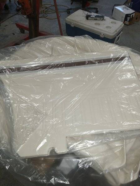

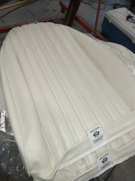

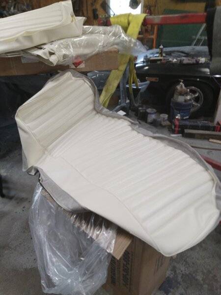

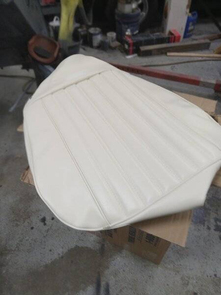

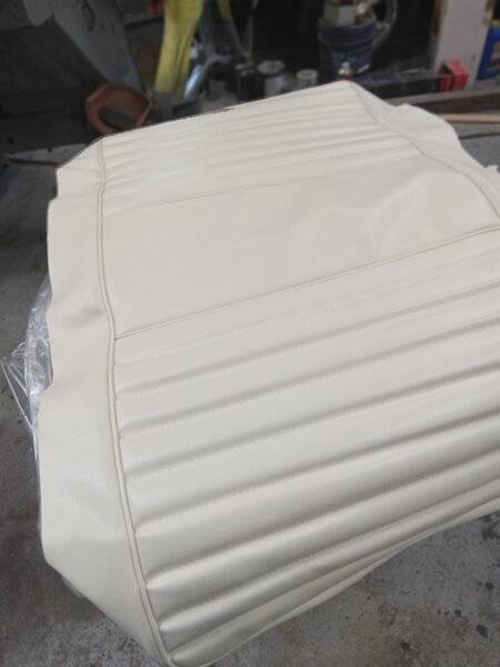

Finally got the seat covers from legendary interior , they appear to great quality an the scoops arrived , got to get back to the painting

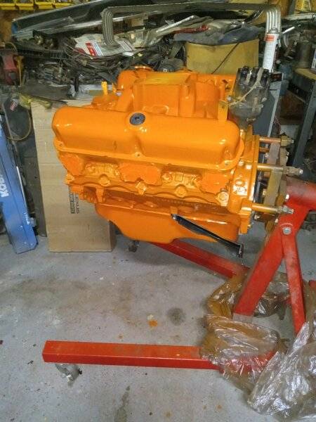

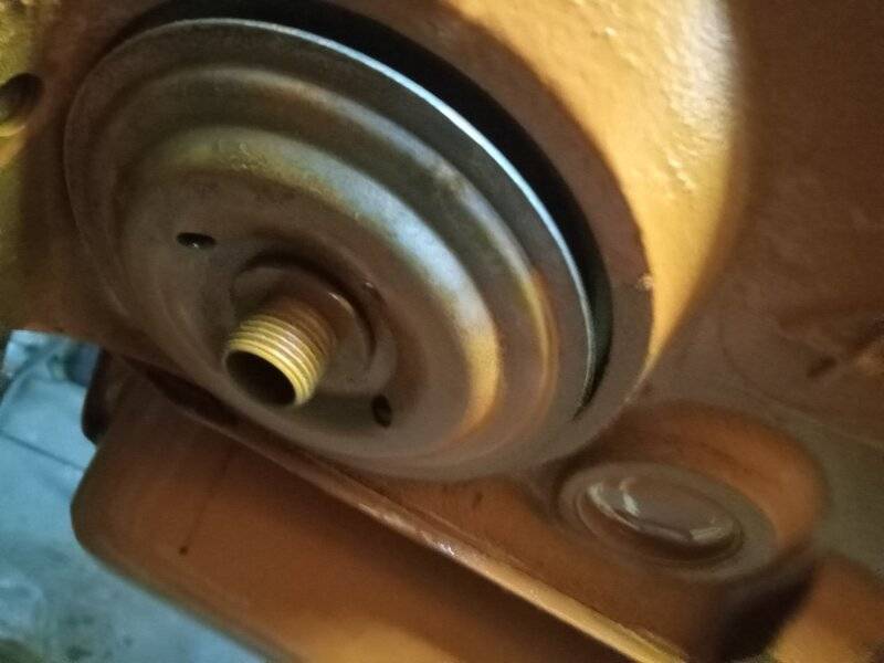

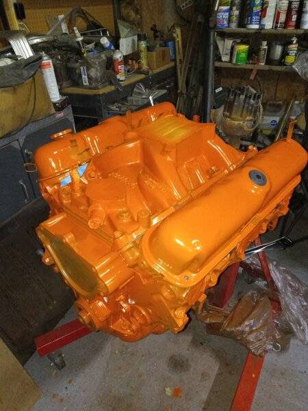

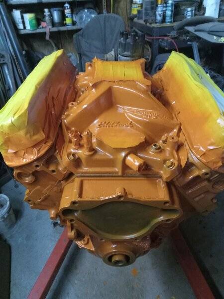

Slow times this year but got some paint on engine and mopar orange always good choice . Question is there a seal or gasket behind oil plate ? rebuilt kit has 2 or 3 different styles that look to fit but when I tore motor down I dont believe there was anything there

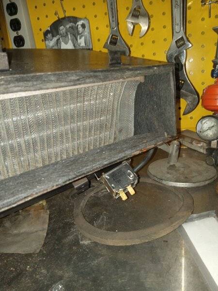

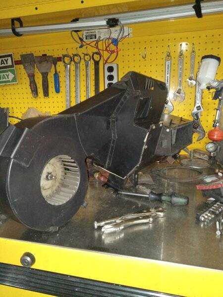

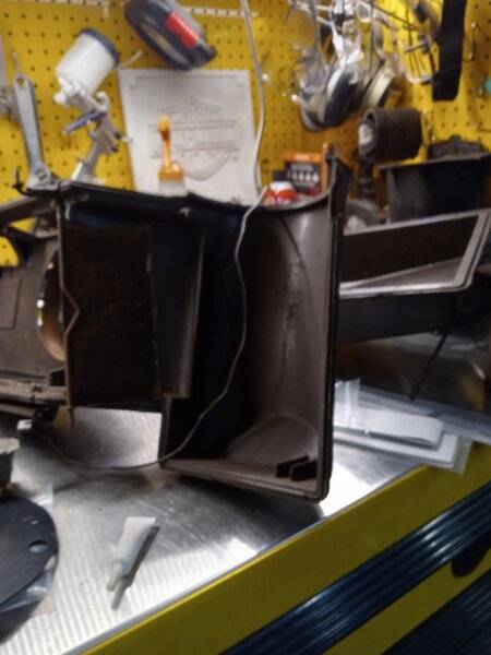

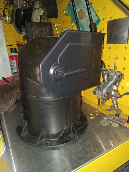

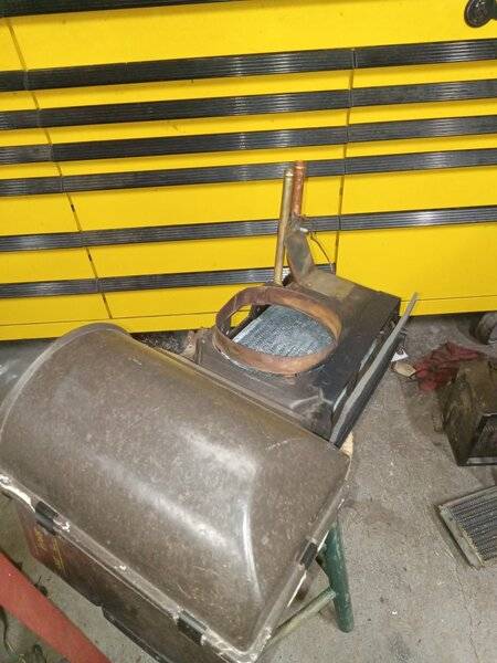

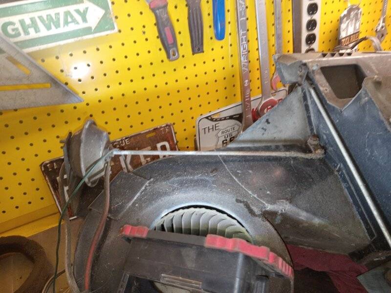

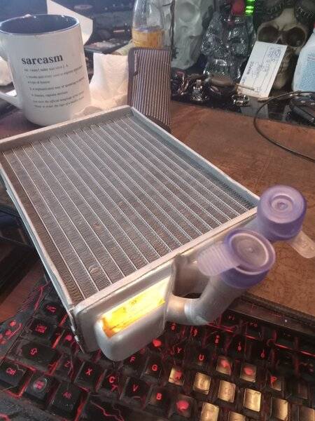

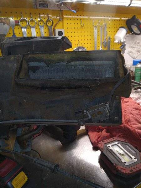

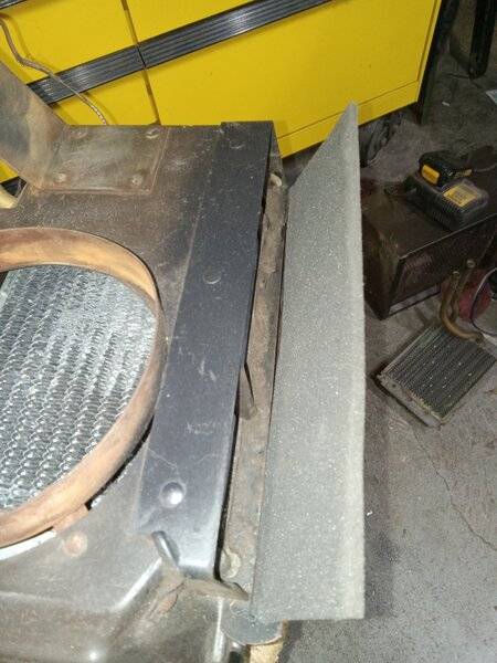

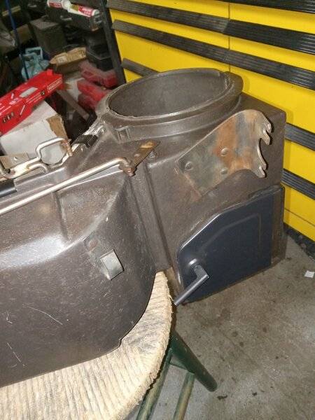

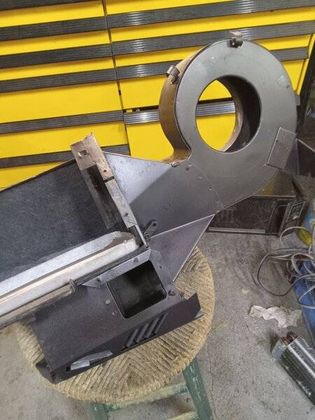

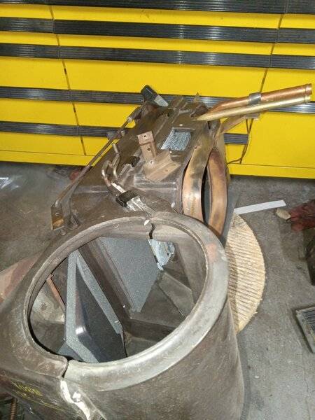

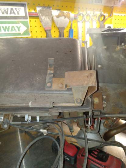

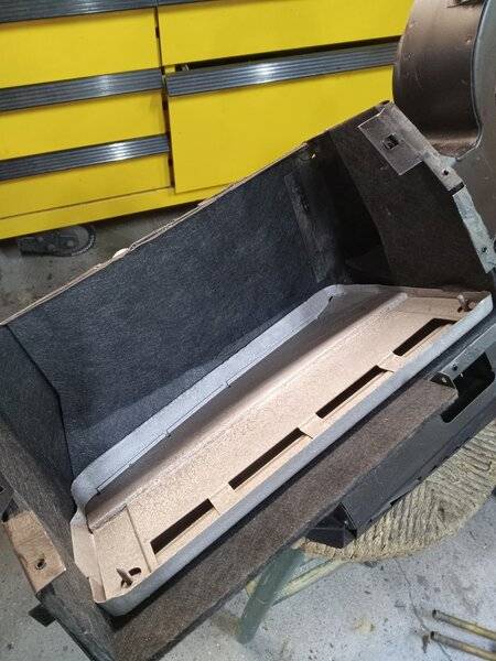

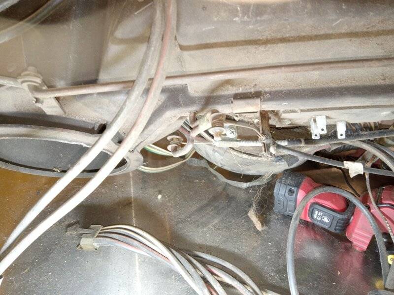

Some small progress , tore into the heater/AC box . found N.OS. blower motor , new heater core an new AC condenser , and new N.O.S. temp probe , and all new seals ,,any one know a source for the vacuum pods ? May be ok but would be nice to replace
Most of box is done , just need to get vacuum pods cleaned or replaced an new lines ,,engine is getting better with mopar orange ,need to source under hood components , have a lead on complete setup on parts car, waiting on reply from seller

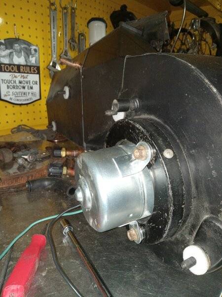

And the blower motor was the worst to replace , does not go together easy , took some effort on getting the mounting pieces in place ,

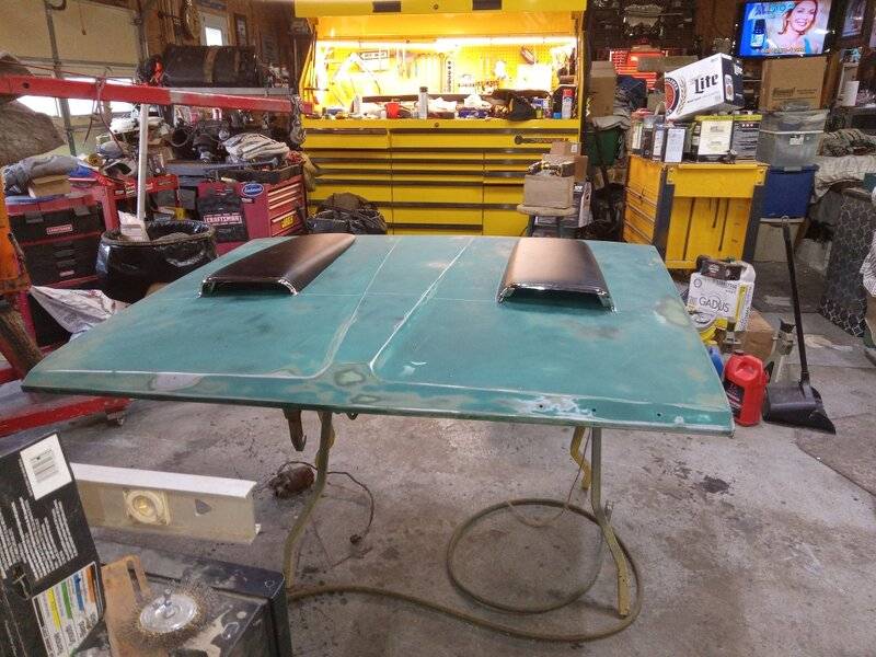

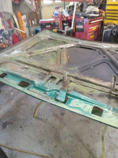

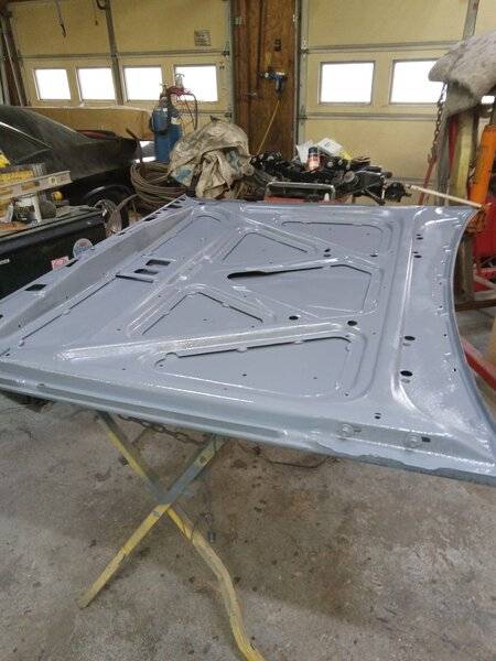

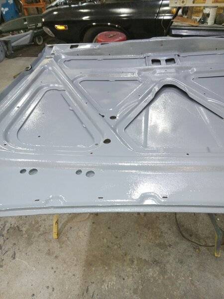

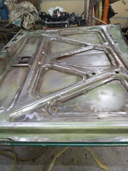

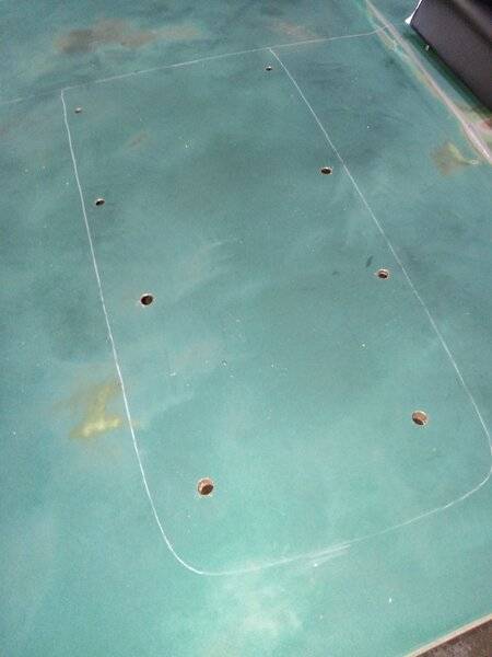

started on hood , getting it ready for epoxy primer and to get the holes drilled for the scoops , hood is very straight an solid , very small areas of surface rust , nothing that wouldn't sand out ,,, wanted to get started back on something until I can finish painting firewall , hoping to get a good start on it this spring and get engine an tranny installed
That hood looks it was in real good shape and you're doing a good job on it. What kind of stripping disc is that? Stiff scotchbrite maybe? What kinda Challenger you got hiding back there?!?! :D
Used wire brush on drill to strip underneath and then sand with heavy grit , very light surface rust , top side just sanding and I do use scotchbrite sometimes , got to finish sanding and get some epoxy primer on it ,, the challenger is a 72 but the outside is cloned to a 70 model grill an tail lights , 340 6 pack 4 spd
