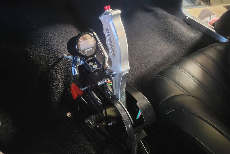

Gosh, where to begin....So the 421 in the Scamp got yanked this past Spring and I did some milling and port work on the heads and got a larger cam. My C/R is now at 12:1. I also ditched that Brawler carb for a custom 950 from IRD and installed a new dual AFR guage by the shifter. She drives great. Pulls very hard after 3800rpm all the way up to 6800. The combination really woke it up - and it wasn't a slouch beforehand, so it should rip.

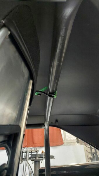

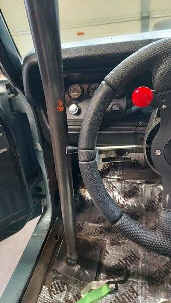

Cage is finally going in! It's a 10-point CM from S&W and we're adding a bunch of extra bracing. The sketch shows the layout that my fab guy sent me. I'm likely moving to a ladder bar setup after this season, so we're going to reinforce the trunk floor direcyly above where the coilovers will be mounted.
My chassis guy is crushing it. He's getting everything super tight, but with just enough space so I can remove the dash.
