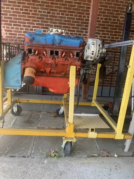

273ci thoughts?
OH, your dislike of he Hyper pistons.... pistons fail for a few reasons. No matter what there made of. You just have to be on your game to start with when you use a Hyper since they will fail quicker when you abuse them/race them. Spark timing & too small of a ring gap are Notorious killers with a hypereutectic piston’s. However, it will do the same to a cast or forged piston. Then It doesn’t matter what the piston is made of. It will take up the whole damn engine.
Below my ‘67 - 318 in reasonable shape. Getting ready for a cam swap, intake and yup! Headers.
Back to the original post.How much power do you want, how much do you want to spend and how are you going to drive your car?
