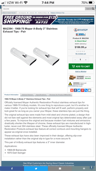

3” stainless exhaust tips for 72 Demon

Hay guys, seen these tips on Classic today. I like the slip-over design but these are listed for 70 Swinger and 2nd gen Baracuda. I’m thinking the 70 Dart should be the same as a 72 Dart, right? Classic has free ship now as well. Thanks

That makes sense, I'm going to take it to a custom exhaust guy here in town. I'll let him figure it out, also going to stay with the 3" from the Doug's to the tips. Yearone has a set to fit the Demon, Duster for a few bucks more. I guess the difference is without the valance, the tips are just longer. I want them to fit over the pipes and not inside like the factory. The Classic and Yearone tips I looked at do attach to the outside.
The difference is where the hanger is located. If you put the valance style on a Duster or Demon with the factory Located hanger the tip from a Cuda or Dart will end up in front of the bumper,

The CA of a std. 16ga 3" pipe is just under 6.5"sq., the area of 2.875" ID, the tips have a CA of over 6.75"sq. by interior dimension. For anyone else who may be curious.
