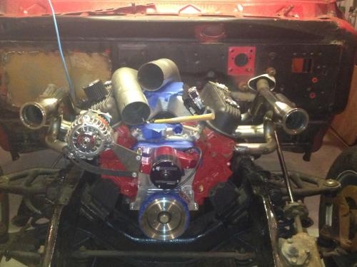

Here is how I did my 318 with a 62-1 T4 turbo, also going megasquirt but with manual steering. 2.5" stainless hot side with 3" downpipe.
I bought a set of headers, the drivers side fits with only manual steering. I completely transformed the passenger side and welded it back together. If you dont mind manual steering, you use magnum truck manifolds and they work just as nice.

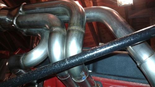

Have you seen this guy? look like he just extended headers out and ran them upside down.. looks good. Pretty easy to extend out.

Im using 44lb injectors, with a MS2 setup. I had wanted to use bigger injectors in case I wanted to run E85 in the future. I used a 750 Aeromotive pump and a trunk mounted fuel cell.
