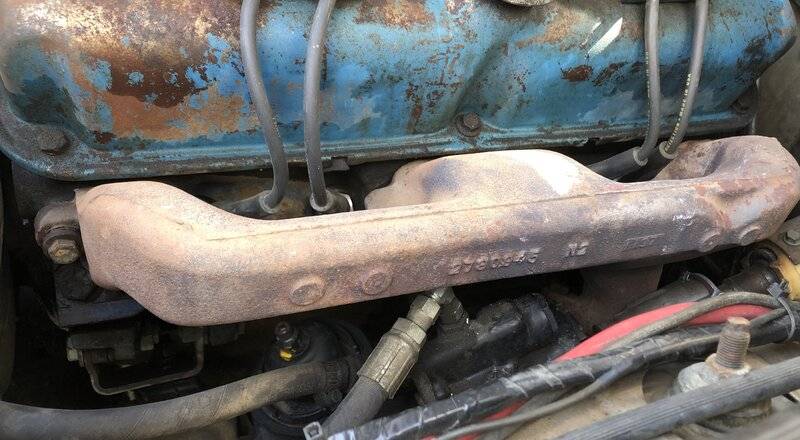

Anyway,I had time off today to try and get more done on the car. I noticed that the drivers side exhaust manifold has an exhaust leak noise when you accelerate. I found that not only were the bolts loose but there was no manifold gasket on that side!

The casting number on the exhaust manifold is 2780945 N2. Im assuming MS 90460 Fel-Pro would be the correct exhaust manifold gasket kit?
The factory didnt use gaskets on iron manifolds typically, and IF the head surface and manifold surface are good, they are unnecessary. If you have pitting or corrosion, then the gaskets are normally enough to seal it up

Thanks for the info. I didn’t think so but wasn’t sure. The passenger side definetly has a gasket on it so I assumed the drivers was supposed to as well. I tightened a bolt down I missed that was still a little loose on the underside of the manifold Will test drive it in a bit. Hopefully it will get rid of the “ticking” sound. If I end up needing gaskets guess I’ll get the fel pro. I read on another mopar thread that someone used permatex ultra copper and it stopped the ticking sound.
Also, depending on the year of the cylinder heads, it may have the little 1/4" air injection holes at the bottom of the port, if it does, make sure the manifold covers that, and if not, you would need to plug those holes

well, they did have a steel shim / spark plug boot heatshield.
That would make sense since my car burned the wires off two spark plugs on that side. Did 360’s get that heat shield shim?
I tightened all the bolts down and it still makes that “ticking” exhaust leak sound.
