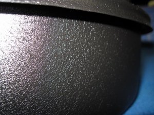

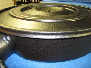

CudaChick1968 Leanna ~ The Mistress of Metal FABO Vendor Joined Jan 17, 2005 Messages 11,204 Reaction score 4,756 Location Greenfield, Tennessee Jul 10, 2010 #2 A lot of people use VHT wrinkle black. I use my powder equivalent. Though this breather is a few years older than yours, you get the idea. Here's a close up.
