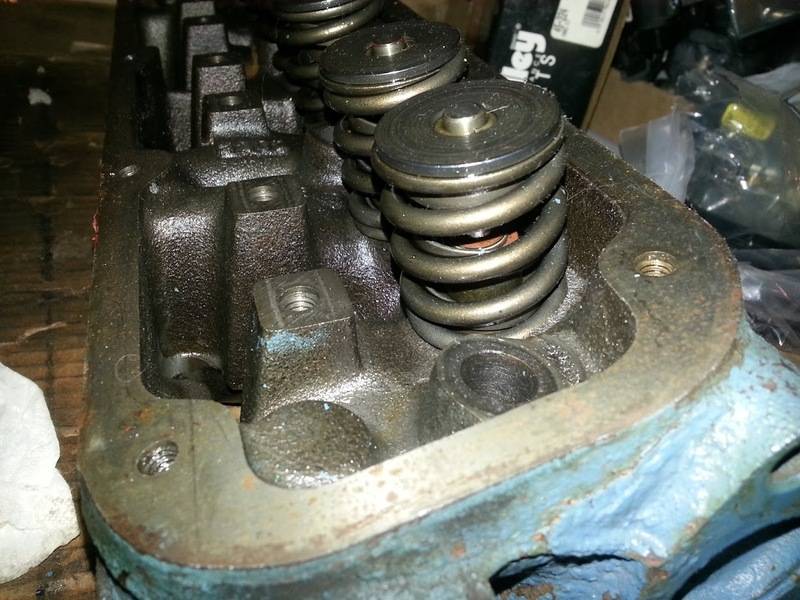

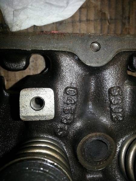

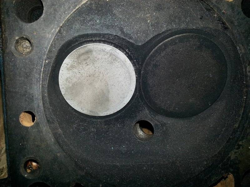

If it helps, here are some pictures of the 53020466 Magnum heads I had run on my 360 and are now on my friend's 71 Demon 318 Magnum:
