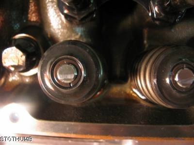

here is photo of chevy roller tip rockers on EQ magnum heads, had to use ford/olds rocker studs (CompCAm part). If your looking for more valve lift this is one way to get it and still keep seat duration shorter for good street manners.

I did 1.5 ratio,to kill lift on E/Q heads. Maximum allowed was .530.The can I picked ,went .550 plus with a 1.6.Back down to .520 .
Minus the lost lift from the lifter/pushrod angle you'd end up less than .500 net. I use higher ratio rockers to make up the loss. LOL
Measures. 510 actual at the intake.. 520 advertised. Go back to Mop arts,spread your crap there(lol!).
look at those valve stems...... not a good wear pattern there
